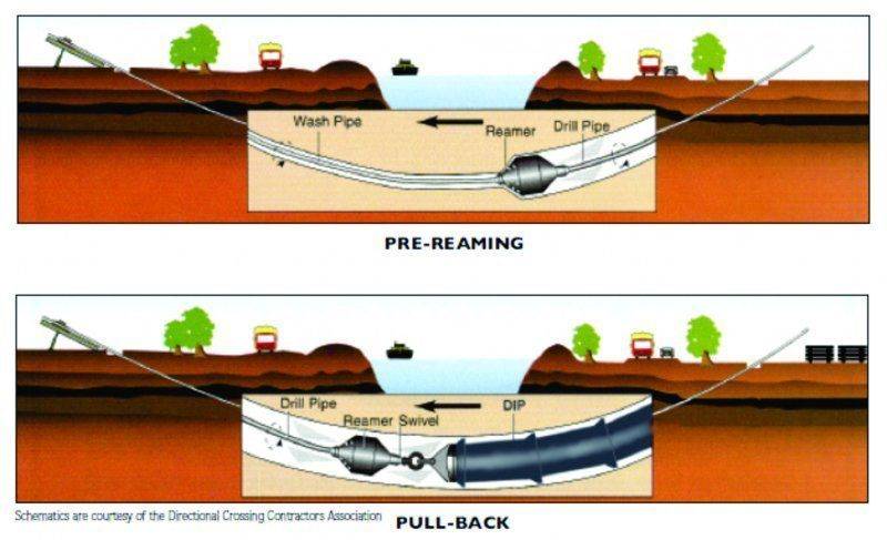

Hello everyone, I am not a physicist nor do I know that much about physics. I do however have a physics question and this seemed like a great place to get an answer. I will present my situation the best I can. I work in the Horizontal Directional Drilling industry. This industry installs pipelines of various sizes underneath obstacles.
My question is this these drills are designed on a radius design. Will enter the ground at a determined angle hold a tangential line then curve along a designed radius then back to a tangential length then back to a curve along a designed radius to a determined angle then back to a tangential length then exit the ground. Will then pull the product pipe back through these vertical curves underneath the obstacle. There can also sometimes be horizontal curves designed into these crossings. I hope this part made sense.
A pipe is then pulled back through the bore path through the vertical and horizontal curves.
My question is this why does the pipe being pulled rotate somewhat, normally less than 150 degrees but it does rotate with no torsional forces being applied.
Could someone with some physics knowledge try to explain this to a physics layman. It would be greatly appreciated because several instances have come up in the past where I was not able to explain why this occurred other than "physics I guess."

Hope this can help in the understanding of the process. My thinking is this and correct me if I am totally off here. The pull may not always be in the exact center of the product being pulled. There is large amounts of pull being applied to the product, there is friction also involved. Then after the product is pulled approximately 30' it is then relaxed while you can prepare to pull another 30' usally less than a minute or two. Then these forces are applied over and over until the product is pulled from point A to point B.
Again I am not an expert in the field of physics but am an expert in the field of Horizontal Directional Drilling. And am about to pull a product and the client wants me to guarantee there will be no twist of there product even though it is being pulled through two vertical curves and one horizontal with no torque being applied to the product.
They are thinking that adding weight to the front of the pulled product will prevent twisting. My thinking is, it could cause more.

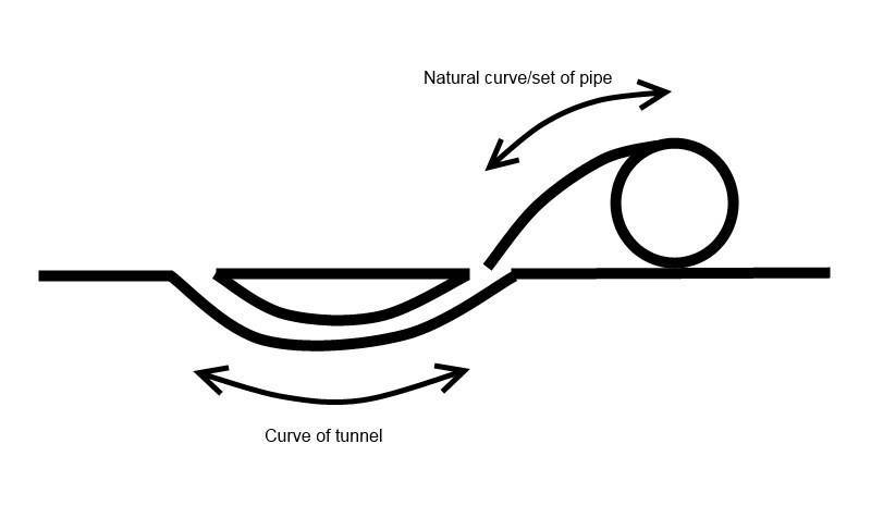

How about this for a guess...
The pipe is delivered on a drum and has a natural curve in it. I'm guessing that when it's put into the ground it is taken off the drum in such a way that the curve of the pipe is the opposite way to the curve of the tunnel in the ground. The pipe therefore has a tendency to rotate 180 degrees so the curves match and stress in the pipe is reduced.
Haven't time just now to do a diagram sorry.
Ok here is a sketch..
It is not on a drum it is welded into one solid piece. Then laid out as straight as possible in the direction of the pull. But it is being pulled through a hole that has a curve. Can the pull forces being applied when pulled through the ground around the curve when relaxed and the pipe is in a relaxed state cause the pipe to rotated ever so slightly. Then this pull then relax process is repeated over and over until the pipe is pulled all the way from point A to point B. Resulting in a rotation of the pulled product. Sometimes it rotates only a few degrees sometimes as much as 180 degrees. These pull forces can be as high as 600000 lbs. depending on the size and length of the pipe. The most recent one was 2700' of 36" steel pipe that averaged close to 380000 lbs of pull to pull it through the hole.
