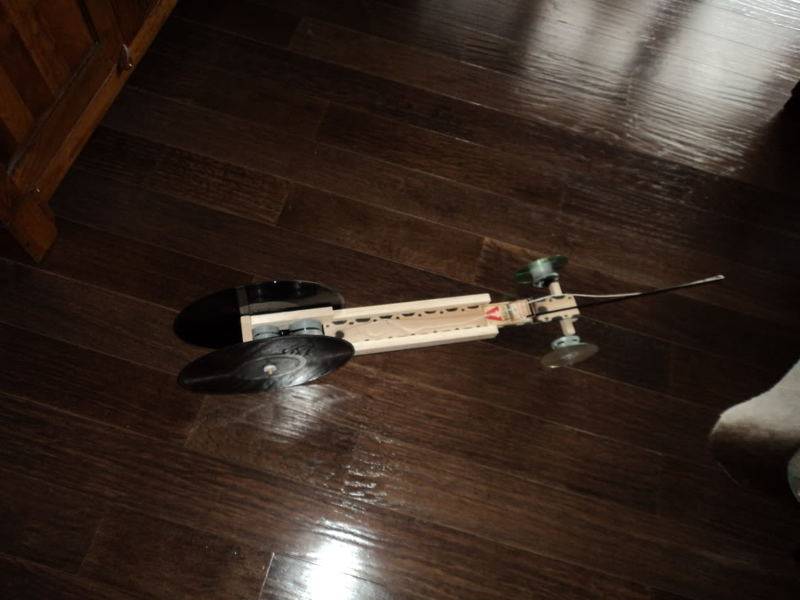

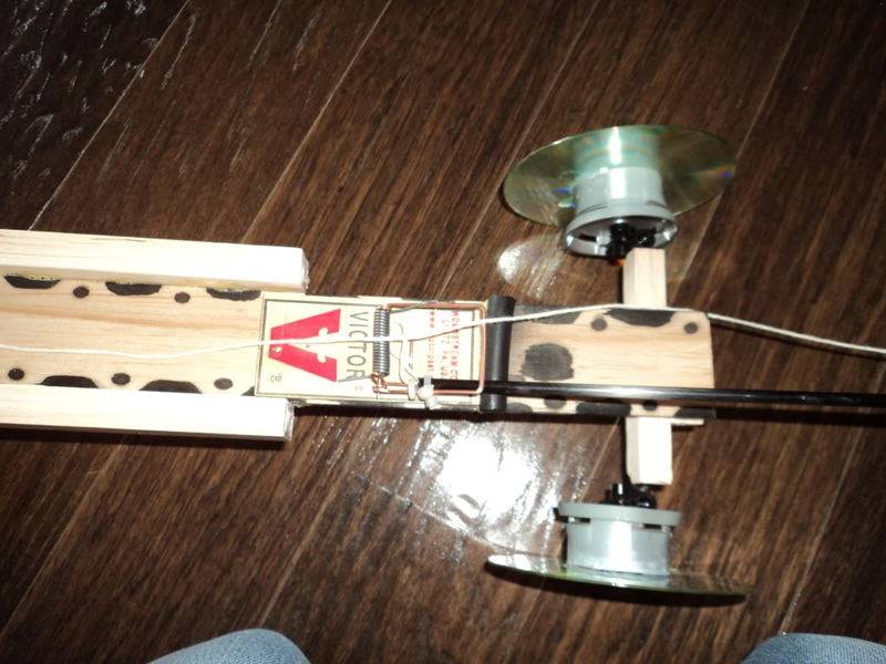

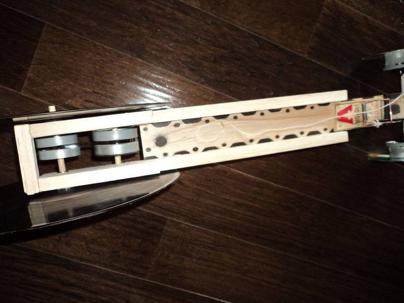

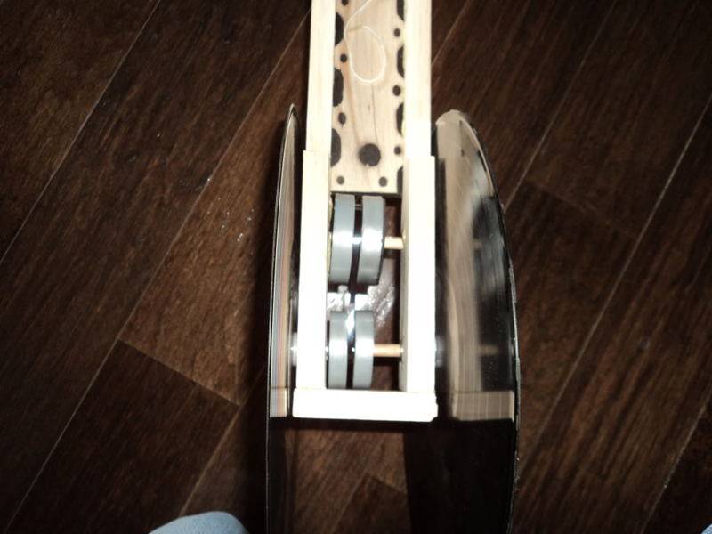

Hey guys! I'm new to Physics Forum and I have a question. I am building a mousetrap car for my 8th grade science class and have run into a problem. I have built a pretty sophisticated pulley system using a cassette tape. The lever arm and string turn the cassette tape which turns the drive axle. I am using two records as my back wheels, and I fear that they are too heavy. Whenever I arm the car and set it down, nothing happens. It does spin very quickly if I give it a little spin.
I will post some pictures of what it looks like.

Do the wheels spin easily when you load each on individually when spinning it with your finger? If individual loading is okay, look to see what is diffferent when you set the car down. Like, do the wood axles bend under load, making them bind a bit on the bearings?
Or, if you just sit the car on the ground and rock it gently back and forth with your finger, does it move easily? If it does, the problem may be in your string/pulley system. What are you using for bearings there? How does it feel to your fingers as you apply load to the string?

From the photos posted I couldn't clearly see it, but it appears you are using vinyl records for the driven wheels. What I said in my previous post would also apply to the vinyl records. The larger diameter vinyl records could give you a higher top speed, but they do take a lot of energy to turn. If speed is not important for your demonstration, then substituting CDs for the vinyl at the driven wheels would reduce the amount of energy it takes to get your car rolling with the mousetrap mechanism.
