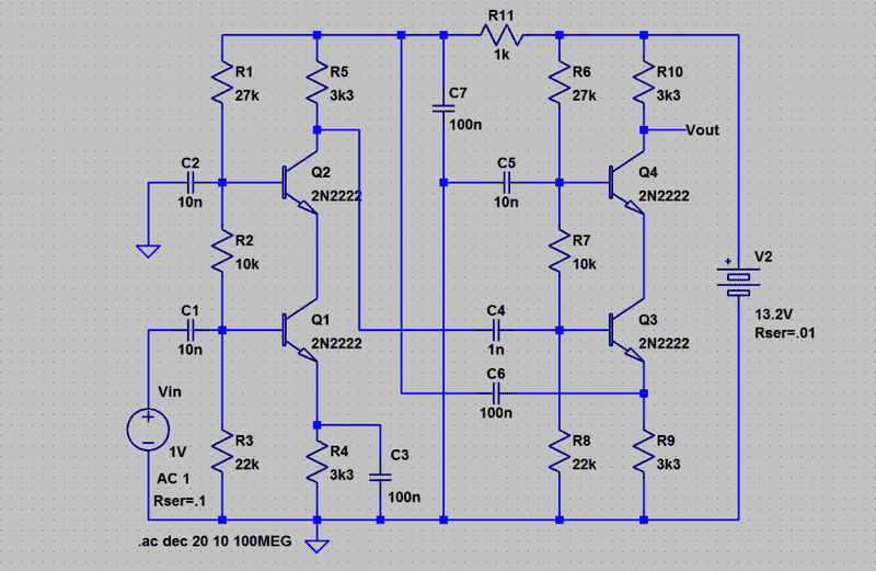

I'm having the worst time ever with a two stage cascode bjt amp. See attached circuit image. In the circuit photo the "In R: 168ohm" is the amps input resistance according to LtSpice. I usually have luck with LtSpice. The circuit shows real measured resistor values. I built a LtSpice version that included the inductance of real wires, which isn't much inductance because I made everything as tight as possible. I don't have any SMDs. So all of the Rs are 1/4 watts. The desired frequency was 49MHz, but it had no gain there. The gain according to LTspice is over 4000 at 49MHz, but at only 41MHz the real circuit was about 5 lol. Vc was designed at 13.2V. If I dropped the voltage on the real circuit to around 12.8 volts the gain went up a bit, but it starts to oscillate.
I'm confused why this circuit is so horrible. I thought cascode amps were supposed to be extremely stable. WikiPedia speaks highly of it, says it even eliminates the miller effect. Prior to this circuit I tried numerous others such as the common emitter. They oscillated, and when I went back into LtSpice and added real inductance from the connections, sure enough, LtSpice showed the high gain amps were extremely prone to oscillations, but LtSpice shows this cascode amp circuit is rock solid. I threw everything I knew at the circuit, realistic supply, excessive wire connection inductance. Nothing. It wouldn't oscillate.
Please, any suggestions?? I'd like a gain of at least 1000 somewhere in the 40 to 50 MHz region. The BFG591 transistors I'm using are 7GHz. I live in the U.S., but ordered these from China because they were so cheap. Is it possible they're not the real deals? A single stage common emitter amp circuit using a BFG591 had a gain of about 70 at 49MHz, which was spot on according to LtSpice. The measured gain on all 4 of the BJTs on a multimeter was 128. Perhaps my problem is in making the circuit to small, perhaps too capacitance between parts? The last idea I have is to replace one of the resistors in the second stage with a pot, which would allow me to adjust the voltage supply for max gain on the first stage amp, and then adjust the pot for max gain on the 2nd stage amp.
Thanks for any help!

Q1 and Q2 don't look to be biased correctly. They should probably have base resistors, and emitter degeneration resistors (bypassed with caps for good frequency response).

Thanks. I'll see what LtSpice shows what kind of gain I can get with emitter Rs. Usually that kill my high gain amps.
The scope shows the Q1 & Q2 have good bias voltages of around 810mV. Were you referring to something else?
BTW I started adding real capacitance to the circuit caused by close connections. Choosing the values is beyond me because I have no clue how much C to add at each connection, but when adding even a small amount, 10pF, from the Q3 & Q4 emitters to ground, LtSpice shows the circuit oscillates. Not sure what the solution is for that.

I have a number of questions about it. The physical layout will be critical, partly because the antenna seems also to be on the same board and so can pick up feedback. I notice you have two cascode amplifiers here, so my feeling is that the gain (60 dB) is too high for stability. Can you explain the capacitor values marked with the mu symbol - presumably it means pF? Also I am unsure about the output circuit, which uses a shunt CR combination. I presume the output load is intended to be 670 ohms?

That's a great point about the antenna. It's about 4" diameter, round receiving antenna that's soldered directly to the first stage amp. I have no tools to know how the amps would react to it in terms of feedback.
All the caps are in microfarads.
The 2nd stage amp is connected to a 9Mohm 10pF oscilloscope probe.
I think you're right. This might be too much gain. Very disappointing, considering how highly people speak of cascode amps. You know this circuit oscillates when the voltage is adjusted so that the gain is about 20. I've had plenty of 2 stage common emitter amps with a gain of over 200 without oscillations. Maybe if I use one of my older common emitter amps with a 200 gain feeding my one and only LT1227 op-amp I could get maybe 4000 gain total.
Well this is definitely a lesson in feedback lol. Would it help to separate each amp stage farther away from each other? Also it might help to move the small antenna farther away with an antenna cable.

One thing at a time. I think I would keep the antenna away from the amplifier if possible. Definitely a bad idea for the antenna to use the amplifier board as a ground plane. I realize that for compact equipment these things have to be done, but not voluntarily. I would also be careful how the oscilloscope probe is connected, as leakage might be occurring. I presume you have a calibration for the probe, as 10pF is very high for use at 49 MHz. Generally I would keep each cascode pair in a separate screened section somehow. Some of the capacitors seem very high value for the frequency being used, and so they might suffer from unwanted resonances. 60 dB is a very high gain to be seeking for an RF amplifier, so is it necessary? Usually we try to keep RF gain to the minimum.

Power supply decoupling can explain the oscillation problem.
C7 = 47uF is too high a resistance cap to calm HF noise. You need something like a 100nF ceramic in parallel.
Also you should have a LPF component, (such as a series 100R), in the +ve supply rail to prevent supply noise getting from output stage back to the input stage.

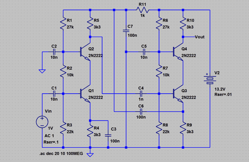

It is usual to place tuned coupling networks between cascode stages.
Input is between ground and base of Q1. Output is across R5.
That output must be coupled into the BE of Q3 with output then across R10.
See the direct coupled two stage cascode attached, shown here with cheap transistors.

Many many thanks for the circuit and help. I'll enter the circuit in LtSpice to see how it works and what kind of gains I can get without oscillations. I found that by entering real inductance between components, as small as they be, and capacitance between lines shows oscillations in Spice sims, if there are any. Although I'm sure your circuit won't oscillate, which would be great.
A gain of 4000 didn't seem like much to me. What if someone needed a gain of a million? I'd imagine the circuit would have to be divided many times, highly shielded, and where each circuit segment would have their own isolated supplies. Perhaps that's one advantage optic circuitry has.

I should mention that it is better if possible to carry out amplification by mixing down to a lower frequency so that stability is better and filters are easier. With your amplifier, gain 4000, the output transistor may be able to supply, say, 1 volt output maximum. The input for this is only 0.25 mV, a small signal. The dynamic range of your system is very restricted, being perhaps from something like 0.25 uV (the noise floor) to 0.25 mV, only 60dB. A good receiver will have a dynamic range of perhaps 100dB. The overall voltage gain of a receiver might be approximately a million, from a microvolt to a volt, but this is obtained easily by using frequency conversion.
Construction would need to be as a strip where there would be a ground wall between each stage or each transistor.
Power would be fed to each stage through a low pass filter network from a supply that flows from output end to input end with LP elements.
This circuit has a gain of about 80dB at 1MHz. Better transistors and some fine tuning will speed it up.
Attached here is the LTspice file.asc
Remove the .txt suffix to make it back into .asc
