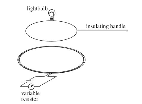

Why wouldn't rotating the handle 90 degrees induce an EMF?

There is some current in the bottom coil.
The question asks which would not be able to light the lightbulb
- rotating the insulating handle 90 degrees
- increasing resistance of variable resistor
-reducing resistance of variable resistor
- moving the insulating handle towards and away from the current carrying coil.
emf = change in magnetic flux over time.
right hand rule for current carrying wire
B = (permeability of free space * current)/ (2pi * radius)
magnetic flux = BA
Rotating the handle 90 degrees would change the area exposed to the magnetic field. All the other choices would change the strength of the magnetic field. Wouldn't all of these choices be able to light the lightbulb?
Perhaps they meant rotating the handle about a "vertical" axis, keeping the loop in the same plane.
Not clear:
1. Rotating the insulating handle which way? Around which axis? If you rotate the handle by 90 degrees about a vertical axi through the center of the coils, then nothing happens.
2. Moving the insulating handle towards and away from... Again, which way?
Thank you for the help, I did not consider the vertical axis.
