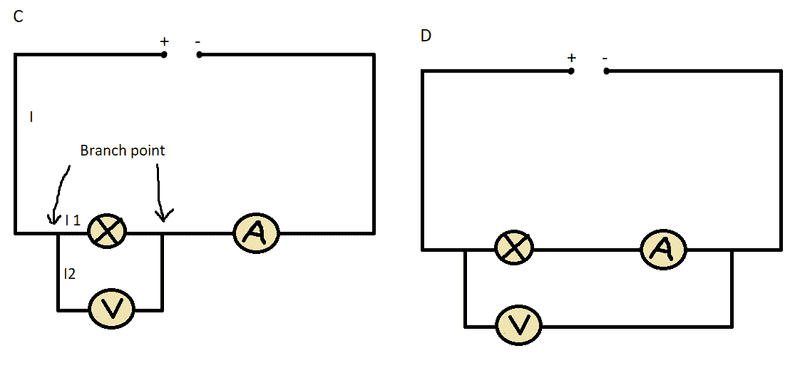

In my physics textbook it says that ammeter in circuit C shows higher current than ammeter in circuit A and D.
And the voltmeter shows higher voltage in D than in B, and C.
It's explained in the book that way: some electric current is passing through the voltmeter in C, thus the ammeter will show higher and current. And in D there's some voltage on ammeter too, so the voltmeter show higher voltage.
But why "some current passing through the voltmeter" would cause more current passing through ammeter?
And why some voltage on the ammeter would cause increased voltage on voltmeter?

Not quite. If the lightbulb has a resistance of 2 ohms and the ammeter 1 ohm, then the total resistance of the circuit (before connecting the voltmeter) is 3 ohms. Applying Ohm's law, the current through the circuit is ##I = V/R = 10V/3Ω = 10/3 = 3.333 A##. Applying Ohm's law to the ammeter to find the voltage across it yields ##V = IR = (10/3)(1) = 10/3 = 3.333 V## Applying Ohm's law to the lightbulb yields ##V = (10/3)(2) = 20/3 = 6.667 V##.
Assuming the resistance of the voltmeter is extremely high, much higher than 10 ohms, attaching it to the circuit will have a negligible impact and it will measure 6.667 V across the lightbulb.
Now, if we have a poor-quality voltmeter, such that the resistance is not quite so high, then it may impact the circuit in a non-negligible way. If we use 10 ohms as the resistance of the voltmeter, then attaching it across the lightbulb in C will put the two in parallel with each other. The equivalent resistance of these two components will be ##\frac{1}{R}=\frac{1}{R1}+\frac{1}{R2} = \frac{1}{2}+\frac{1}{10} = \frac{5}{10}+\frac{1}{10}=\frac{6}{10}##. Dividing both sides by their denominators yields ##R = \frac{10}{6} = \frac{5}{3} = 1.667 Ω##.
Total resistance of the circuit is now ##1.667 + 1 = 2.667 Ω##. The current is now ##I = V/R = \frac{10}{2.667} = 3.75 A##.
So attaching our (poor quality) voltmeter has increased the current from 3.333 Amps to 3.75 Amps.

E is identical to C. The order of the components does not matter in this case. As for what's happening with the voltmeter in B and D, I can't answer that. I can't see why the voltmeter would read a higher voltage.

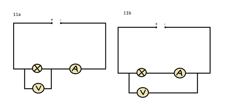

"If we want to measure both the voltage on, and the current through the light bulb at the same time, we can connect the measuring devices in two different ways (the picture above). Do you think these two connections will give same results? If that should be the case, the current through the voltmeter and the voltage on the ammeter must be equal to zero. It's same as saying that the resistance in the voltmeter must be infinitely big, and the resistance in the ammeter must be equal to zero. In reality some current goes through the voltmeter, so that the ammeter in 11a show a bit too high current. Furthermore there are some voltage on the ammeter too, so the voltmeter in 11b shows a bit too high voltage."
Karagoz said:
I don't know how the "voltage drop" works. I thought it like this: electrons like some cars in some on road that move from (-) to (+). So in C, the cars slow down when moving through ammeter (like cars slow down in speed bumps), so when they reach voltmeter they have "lower speed".
But in E, since the cars reach the voltmeter first before any speed bump, there's no drop on speed.

Karagoz said:
And this is what's written in the textbook, I'm translating it more precisely (from Norwegian):
(the source is a voltage source, DC).
In 11a, you are measuring the voltage drop across the lamp ONLY. This will be a portion of the total voltage drop
In 11b, you are measuring the voltage drop across the lamp AND the ammeter and the measured value will be the value of the battery voltage

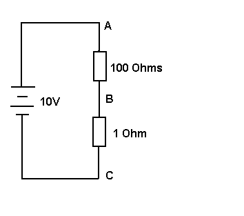

you could replace the lamp and ammeter with 2 resistors of different values ( I think some one mentioned this in an earlier post)
lets make the battery/voltage source 10V, the lamp a 100 Ohm resistor and the ammeter a 1 Ohm resistor
Knowing the voltage source = 10V and the values of the 2 resistors, we can work out the current in the circuit
tell me ...
1) what is the total resistance ? _________
2) knowing that, what is the current ? ___________
do you know how to do that using Ohm's Law ?
now knowing the current and the individual resistances you can work out the voltage drop across each resistor
Again use Ohm's Law
Vdrop across 100 Ohm = __________
Vdrop across 1 Ohm = ____________lets see how you go with those problems :smile:Dave

1) Total resistance is: 101 ohm.
2) Current is: 10/101 = 0.099
Vdrop across lamp: 0.099 * 100 = 9.9 V. This is voltage on the lamp.
Vdrop across ammeter: 0.099 * 1 = 0.099 V. This is voltage on the ammeter.
In circuit C and E it measures voltage of the lamp only, but in D it measures voltage of both the lamp and the ammeter. That means in D, more current will pass through the voltmeter, since there are
In circuit C and D, the current will be divided in two in the first branch point, then get together in the second branch point.
In circuit D, because there are more resistors (the lamp and the ammeter) than in C (only the lamp) after the branch point, then when the current is divided, there'll be more current in I2 in D than in I2 in C. And more current causes more voltage (when the resistance is constant).
The current in I2 is determined solely by the resistance of I2 and the voltage across it. In C, the voltage drop across I2 is slightly less than the voltage source because the ammeter is in series with I1 and I2 and will have non-zero resistance and voltage drop. So some of the voltage is spent in the ammeter instead of in I1 and I2. In D, the ammeter is not in series with I1 and I2, it is part of I1. Since I2 is in parallel with I1, which now includes the ammeter, and has no other components in series with it, the voltage across it is equal to the voltage source. Similarly, the voltage drop across I1 in D is also equal to the voltage source, though it is divided between the ammeter and the resistor.
Drakkith said:
Karagoz said:
But what about the voltmeter in E, D and B?
Will the voltmeter be higher in D than in B? If so why?
Hmmm. The last part of this doesn't make much sense to me. The voltmeter is in parallel with the entire other branch (lightbulb in B and lightbulb + ammeter in D) and should read the same voltage as far as I know. Inserting the ammeter into circuit D merely increases the resistance of that branch, but has no effect on the current through the voltmeter, so the voltmeter's reading shouldn't change. The voltage drop across the ammeter + lightbulb branch is split among both devices, but the total voltage drop for that branch remains the same as before. I don't know if the book is wrong or if I'm wrong (I'm far from an expert. I'm in the middle of ECE 220, "Basic Circuits").
I think there is something people have been missing. Remember, this whole exercise is dealing with "real-world" devices, voltmeters that are not ideal infinite resistance, and ammeters that are not ideal zero resistance.
So I think we should also apply that to the voltage source - assume it has some real-world internal series resistance. When we do that, we can see that the addition of the ammeter resistance in D will reduce the total current in the circuit, and that will reduce the drop across the voltage source's internal resistance, raising the voltage measured across the voltage source.
[edited to remove a follow up comment that was off base]
