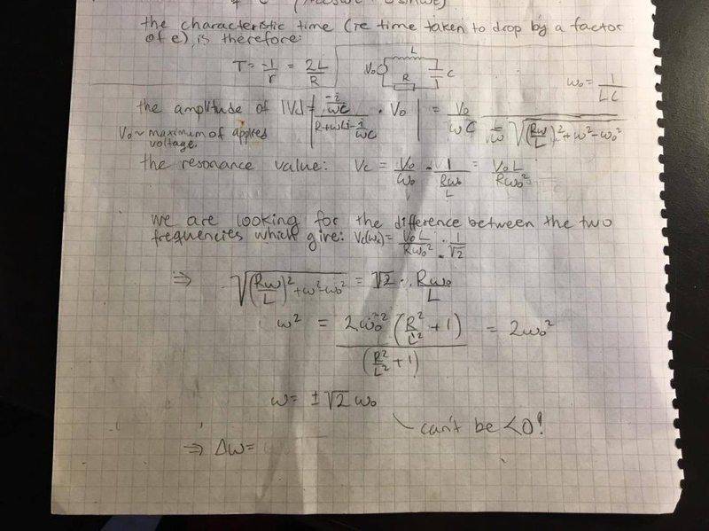

I have attached a photo of my attempt at a solution. The basic method is the following:
1. By using the fact that the current through the capacitor must be the same as the total current supplied by the voltage source, I find that the amplitude of the voltage on the capacitor can be expressed as:
## |V_c| = \frac{V_0}{\omega C} \cdot \frac{1}{\sqrt{(\frac{R\omega}{L})^2 + \omega^2 - \omega_0^2}}##
2. I find the resonance value to be: ##V_c(\omega_0) = \frac{V_0L}{R\omega_0^2} ##
(this uses the assumption that R is small)
3. I want to find the two values of ##\omega## which yield ##V_c(\omega) = \frac{V_0L}{R\omega_0^2} \cdot \frac{1}{\sqrt{2}} ##. The difference between these values should be the width we are looking for.
This gives an equation with the solution ## \omega = \pm \sqrt{2} \omega_0##. Something must be wrong, because ##\omega## cannot be negative, and this doesn't produce the required result either.
What have I done wrong? Many thanks for all help! :)
How do you prove this 'fact' ? At resonance, the current through the resistor is ##V_0\over R## I seem to remember.
Well, all components are in series. Thus, by Kirchhoff's current law (esentially conservation of fundamental charge) the same current must run through all components. This is the "total current supplied by the voltage source", which at resonance when the reactive parts of the impedance cancle is indeed ##V_0/R##.
If you make the substitution ω←##\frac 1{\sqrt {LC}}## in your expression for ## |V_c|## what do you get for Vc at resonance?
Oh, there's a misstake, isn't it? I thought it would be ##\frac{V_0L}{R\omega_0^2} ## but it should be ##\frac{V_0L\omega_0}{R} ##, shouldn't it?
But does that change anything at all? Isn't the basic equation still ## \sqrt{(\frac{R\omega_0}{R})^2 + \omega^2 - \omega_0^2} = \sqrt{2} \cdot \frac{R\omega_0}{R} ##
Umm, is that an R in the numerator and an R in the denominator?? :wideeyed:
What I intended earlier, exactly: :confused:
If you make the substitutions ω←##\frac 1{\sqrt {LC}}## and ωo←##\frac 1{\sqrt {LC}}## in your expression for ## |V_c|## what do you get for Vc at resonance?
Right, that's VC at resonance. And this can be written ##\frac {V_O}Q## where Q is the Q of the circuit.

Isn't the basic equation still ## \sqrt{(\frac{R\omega_0}{L})^2 + \omega^2 - \omega_0^2} = \sqrt{2} \cdot \frac{R\omega_0}{L} ## with soultion ##\omega = \sqrt{2} \omega_0 ## which cannot be right?
Earlier in the maths, have you said that ##{(\omega\ – \omega_0)}^2\ =\ \omega^2 – \omega_0^2## ?
No I haven't, but I seem to have completely missed the square! And a factor 2 in one of the lines...
Okay, So I have tried reworking it. If I am not wrong, the equation I have to solve to find at which ##\omega## the amplitude is ##1/\sqrt{2}## of the maximum is:
## \sqrt{(\frac{R\omega_0}{L})^2 + (\omega^2 - \omega_0^2)^2} = \sqrt{2} \cdot \frac{R\omega_0}{L} ## . This is a rather ugly equation, which yields:
## \omega^2 = \omega_0^2 - \frac{R^2}{2L^2} \pm \sqrt{2\omega_0^4 - \omega^2 + \frac{R^4}{4L^4}} ##. This seems rather far away from proving ##\Delta \omega = 2L/R ##, especially because taking the square-root of that expression will give an algebraic jumble... Have I done something wrong?
We'll go with your first equation in post #11. :smile:
Your equation has (ω - ωo) so keep that together and try again to isolate that term on one side of the equation. Show your working here.
BTW, I do obtain their final answer.
Okay! So we have:
## \sqrt{(\frac{R\omega}{L})^2 + (\omega^2 - \omega_0^2)^2} = \sqrt{2} \cdot \frac{R\omega_0}{L} ## .
(Note: My equation in #11 had a misstake, one of the ##\omega_0## is actually supposed to be ##\omega##... (as seen above) Is this a problem or did you calculate with it?)

I think since we are interested in small range ##\Delta\omega=\omega-\omega_0<<\omega_0## of values around ##\omega_0##, the following approximations are valid ##\omega+\omega_0=2\omega_0+\Delta\omega \approx 2\omega_0##. Hence ##\omega^2-\omega_0^2=2\Delta\omega \omega_0##. Use that and start from equation at post 11, it doesn't matter if it is ##\omega## or ##\omega_0## in there because ##R\omega=R\omega_0+R\Delta\omega\approx R\omega_0## since R is small and ##\Delta\omega## is not very big.
Likes Marcus95
Thank you very much! I finally got it now
##(\frac{R\omega}{L})^2 + (\omega^2 - \omega_0^2)^2 = 2 \cdot (\frac{R\omega_0}{L})^2 ##
## \rightarrow (2\Delta\omega\omega_0)^2 = (\frac{R\omega_0}{L})^2##
giving ##\Delta\omega = R/2L = 1/T ##, thus the total width of the resonance is ##2/T## as was to be shown. :smile:
