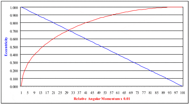

Further to my earlier post, I thought it would be interesting to plot elliptical orbit eccentricity (e) versus relative angular momentum (Le) for constant a. A line applies when e = 1 and a circular orbit (radius a=b) for e = 0. Since Le = m.v.b, the plot is really just e vs b. Clearly, for a natural satellite to convert from an elliptical orbit into a circular one requires a variable amount an angular momentum boost dependent on initial e.
Responding to SNORKACK: I agree that: “tidal forces are actually increased by 40 %” not 30% (Incidentally, it was Newton who first proposed the inverse cubed law); “Moon could only keep a face towards Earth if the orbit were circular” and since I have not done the work I trust that you have, so I assume that “the size of tidal forces changes through a large range”. Thank you for drawing my attention to these extra facts.
Responding to JANUS: I accept your algebra that is found in textbooks and web articles. The energy that you cite is of course total system energy summing potential gravitational with kinetic energies. However, orbital angular momentum is a function of the varying radius and varying kinetic energy and is constant for a given eccentricity. My errors were not to specify ‘kinetic energy’ for the orbits and also to overlook that the period IS constant for all eccentricities as indicated in the statement “...orbital period (T=2πa/√[GM/a])...” Thank you for drawing my attention to my errors and accepting that angular momentum is variable with eccentricity for constant a.

It is not a secret that you can fully determine the shape of an orbit (e. g. determine semi-major axis and eccentricity) by giving energy and angular momentum. To change something, you have to change energy or angular momentum. We know mechanisms to do so - tides, for example. The Moon is gaining energy and angular momentum from Earth.
In keeping with PF’s principle of problem solving, I would like to say that the debate stemming from Edward Barrows post of 28 Jan. 2017 has been illuminating for me for my quest to understand elliptical orbits a bit more. With thanks to those who responded to my first post, I have learned that the moon’s orbit is expanding but not necessarily into a circular orbit. I believe that my first assertion that it is not possible to add angular momentum to an orbit without changing other parameters (as per moon) is correct.
Just because all orbits with a constant semi-major axes (a) share the same total energy and period there is no simple physical mechanism that allows one to migrate to another and ultimately to a circle. No doubt NASA can manipulate artificial satellites to perform such feats but most probably with several manoeuvres and expenditure of energy. An excellent qualitative description of such manoeuvres may be found at:
http://www.rcptv.com/spacetec-ita/changing_orbit.htm under The Effect of a Rocket "Burn"
A misconception seems to be that the equivalent circular orbit of an elliptical orbit is centered at the middle of the ellipse presumably because it still has a radius of a. Without elaborating further, I present a figure below that shows how a family of constant a ellipses morph into a their equivalent circular orbit all having a common (attractor) focus. I leave it to the reader to deduce the interesting geometrical features.
Recall that total energy comprises kinetic and potential components. Therefore as b increases so the angular momentum increases and when b = a then the kinetic and potential energies equate to a maximum for the former.
