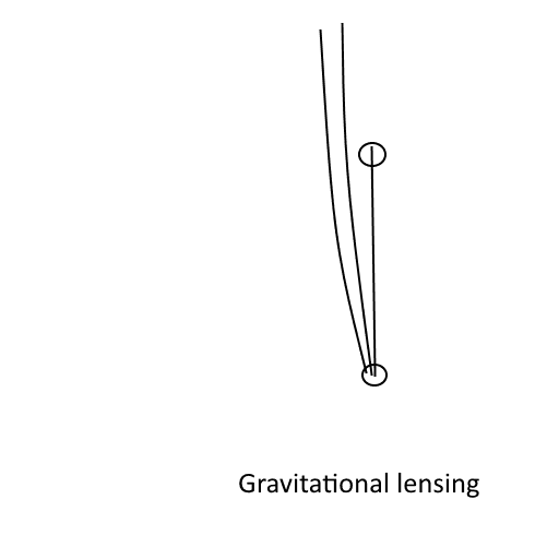

The following diagram might help. It illustrates only one aspect of your problem, gravitational lensing.
Star A, at the bottom of the page, emits light towards star B. We use the geometric optics approximation to treat the path the light takes.
The gravity of star B "bends" the light beams. (Feel free to say that the space-time curvature of star B bends the light beams if you prefer. I think saying that gravity bends the light beams is a better choice for the level of this thread). Beams that approach star B more closely bend more. The diagram greatly exaggerates the bending efffect ans was not computed in any way, it's very qualitiative.
I've only drawing a few possible light beams. There are actually an infinite number of them, of course, so if you pick a particular observer, there will generally be a light beam passing through the observer, that light beam will show what the observer sees. Exceptions exist of course, one of the simplest example is that beams that are emitted from star A directly towards star B will hit the surface of star B and stop. THis means that an observer "behind" star B can't see star A, because star B is in the way.
Exactly where you observers should be on this diagram is unclear to me. In general, though, I'd say that the laser beam would have to be tilted to be non-parallel to the light from the star to be visible. This is true even in the absence of gravitational lensing.
If you draw a similar picture, and use the rule that "closer light beams are bent more", you can possibly answer the part of your question that relates to gravitational lensing. To draw such a diagram you would need to have a basic familiarity with geometric optics (though you might be familiar without being familiar with what it's called). I can only hazard a vague guess as to what you might or might not be familiar with, based on what questions you ask. The keywords might serve as a good guide for further research on your part, though.
There is another effect, though, due to the motion of the stars, called stellar aberration. I'm not going to go into that effect, though, it would be too much to cover. But it's potentially relevant to your question.
You asked about the effect of the radiation from star B. The basic effect of the radiation is that it would increase the amount of gravitational lensing as compared to a star that did not radiate. The effect should be very minor and may be unmeasurable in practice.
