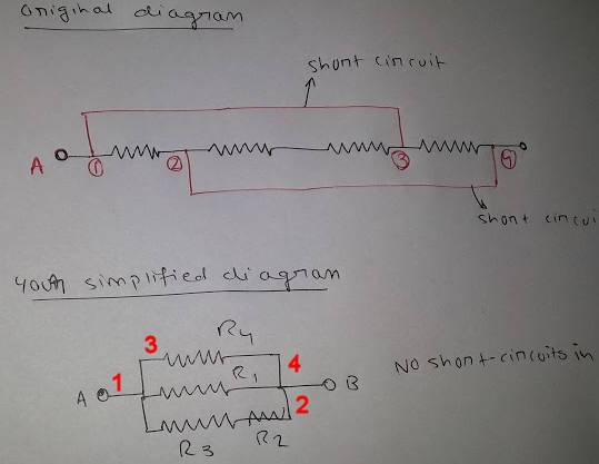

I had to find the resistance of this circuit between A and B. My teacher said that since the blank wires have zero resistance, the potential difference across the ends of the blank wire is zero(according to v = ir) and thus 1,4 are equipotent and 2,5 are equipotent and the circuit is thus simplified.The equivalent resistance comes out to be 2r/5.
MY QUESTION:Will charge flow only through the circuit having resistance or will it flow through the circuit having no resistance or will it flow though both the branches.
MY REASONING:Actually i am confused.
One way in which i can reason is:the potential difference across each branch of a parallel circuit is same and in this case it is 0 and hence no current can flow thorough 1-4 and 2-5.
Second way i can reason is that current always chooses the least resistant path and hence all the current will flow through 1-4 and 2-5.

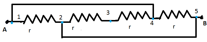

The drawing is intentionally misleading. Manipulate it a little bit to make it clearer:
1) Put 2-4 upright by pulling 2 down and 4 up. You get a diamond shape with 1-2 on the lower left and 4-5 on the upper right; 2-3-4 is the vertical axis.
2) shorten 1-4 and 2-5 until grokking is (*) :smile:

No, this is EXACTLY what the problem is supposed to teach you --- how to change circuit diagrams so as to show clearly what is serial and what is parallel. If we redraw the diagram we are spoon feeding you the answer to this question and that is against forum rules.
And by the way, this specific example is a classic for teaching circuit redrawing. We've seen it here before several times. You need to figure this one out on your own now.
Likes BvU and cnh1995
donaldparida said:
@BvU could you please provide a diagram. I am finding it hard to imagine the changes.
Well, go step-by-step.
Name the resistor terminals as a,b,c and so on and connect the equipotential terminals together.
Edit: I see the terminals are already numbered. Nvm, you can use the numbers directly.

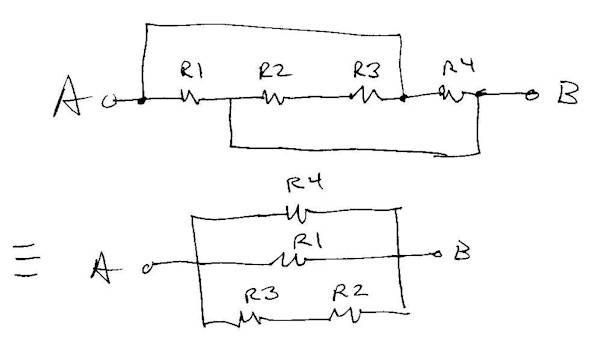

I think you are likely over-thinking it and making it harder than it is. Perhaps this will help you see where it is best to go with such problems. Once you get used to following the lines from A to B, this sort of thing becomes trivial.
Likes cnh1995 and donaldparida
@gneill , i am facing one problem. Due to the branch with zero resistance, the net resistance between the two branches becomes zero [(r1r2)/(r1+r2)]. Then how can we calculate the equivalent resistance between A and B since it should also be 0 then. Shouldn't it be?
Did you not believe the validity of the diagram I posted? If not, please show where you think it is wrong.

Can you draw a path from A to B that does not pass through at east one resistor?
@phinds The zero resistance branch has has same potential across its ends( zero potential difference across it) and is a short circuit. When you are representing the equi-potent points by a single point you are ignoring the short circuit, which has zero resistance (through which the current should flow) and which should make the equivalent resistance of the parallel branches zero and that's where i have a problem.
ONE MORE TIME ... show me what is wrong, EXACTLY with the circuit I drew and do with with a drawing. There IS no short circuit from A to B. If you think there is, show it.
Seriously, you are making this a whole lot harder than it is. Just follow the paths in my diagram and mark them with a red pen or something on the original and you'll see where your mistake is.
When the equipotential points are represented by a single point, it means those points are "connected" together. A conducting wire in a circuit can be represented by a single point or 'node'. So the long wire joining 2 and B is just a node in the circuit.
Also, it is not shorting out the intermediate resistors. Yes, V2B=0V, but that doesn't short out the resistors.
V2B=V23+V34+V45.
Now V2B=0 doesn't mean the RHS voltages are zero. There will be current through those resistors.

@phinds https://drive.google.com/open?id=0B3IenBvKWb4PZEI1VFVmMkxVbHE2UFRXeEJLQ3lydW5oSXRV
  • #31
Your "short circuits" are simply wires connecting components. There's nothing special about these wire connections. Neither of them are in parallel with any components in the strict definition of "parallel connection". Geometric layout on a drawing does not make things parallel; It's the connection topology that counts.
Contiguous wire pathways on a circuit diagram comprise nodes. It's the connections of components between nodes that define the circuit topology. You can stretch or bend or otherwise contort the drawing of these nodes in any fashion you like so long as you don't change what connects to them (components). You can move any connection to a given node to any location on the same node without changing the circuit topology.
You need to practice "morphing" circuit diagrams by bending or stretching node wires, or "sliding" connections along a node to make the circuit more easy to comprehend. With a bit of experience this will become much easier, and you'll wonder what all the fuss was about.
You should be able to follow three distinct paths from A to B on your original diagram. By distinct I mean that they each pass uniquely through a subset of the components, never passing through the same component twice or passing though a component that is covered by another path. Wires do not count as components: you are allowed to use the same wire for multiple paths. Those three distinct paths will be three parallel branches (in the strict definition of parallel connection) that connect node A to node B.
Likes donaldparida

Yes, I also don't see a mistake in @phinds 's redrawing of the circuit. It's just the topology that matters here!
