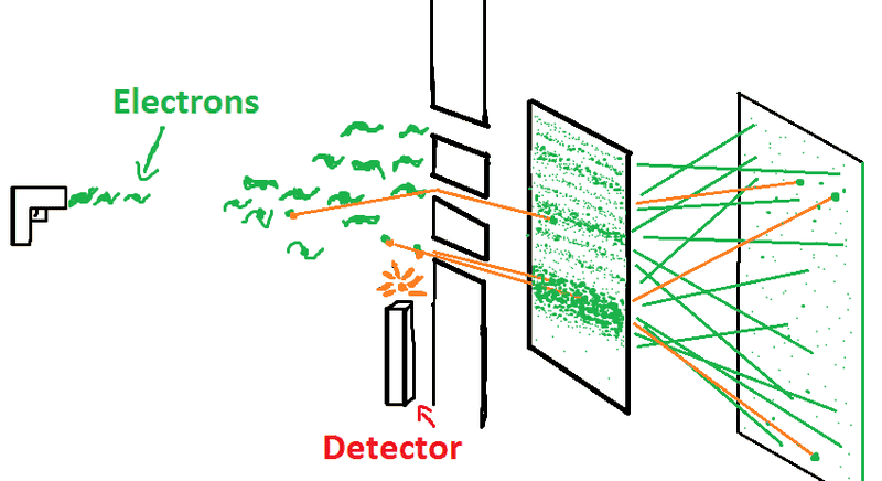

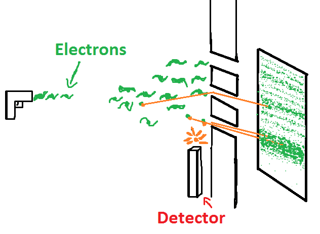

Let's take for example, an electron gun that shoots one electron at a time towards a wall with 3 slits. and behind it is a photographic plate. if the detector is turned off you'll get a diffraction pattern, that looks pretty much the same as a double slit.
But let's say, we do turn the detector on, which is like a low energy photon emitter. In a perfect world we can't turn on the detector, and only have it detect just one slit, but, regardless the result would be the same. We would have a high intensity region closest to the detector, and further away from it, the interference pattern shows. the reason is the nature of the detector, which is just photons hitting the oncoming electrons, which knocks them out of their superposition and gives them a defined trajectory.
Now don't be fooled by the depiction. Those electrons represented as wavy things, aren't really waves nor are they really particles with definite trajectories. Only until the detector has hit them, do they gain a definite trajectory. The electrons exist in a special state where they have the potential to be anywhere in the picture, with a given probability of being detected at a given location. It's only when the photons from the photon emitter interact with an electron, do they gain a trajectory.
Now diving into how the photographic plate actually works, keep in mind, that the photographic plate itself is also a detector. is just a solid surface with indicators, or light switches that flick on when hit with the force of that electron. If one were to create such a plate, where the electron does not stop but still interacts with the plate, then what happens is the plate is like a secondary detector. The plate would collapse the superposition of the incoming electrons, and any electron passing beyond the plate would have a definite trajectory.
However, if we were to only have one electron for example, and once it passes through the first plate, the plate itself changes the trajectory of the passing electron with an unknown momentum, and so when the passing electron were to hit a 2nd plate, the position it lands will be different then when it passed through the first. Given the amount of interaction from the plate, i don't exactly know what it would look like, but i would imagine it being a jumbled mess, basically dots everywhere dispersed randomly.
Now I'm not sure if this is the actual case or not, and could be up for debate, but i assume that this conclusion is solely based on the nature of the plate itself, and how it would actually work.
