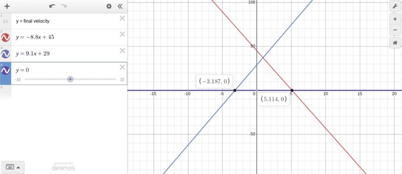

STORY PROBLEM:
Sarah is speeding down the highway westward at 65 mph. She notices ahead that an accident has resulted in a pile-up in the middle of the road. She slams on her brakes 35 meters from the accident, causing her car to slow at a rate of 9.1 m/s^2. Andrew is traveling the other way on the same highway at 45 m/s eastward. He also notices the accident and begins to brake 20 meters from the accident. His car decelerates at 8.8 m/s^2. Assuming a damaged car will keep them home from work, which of the two people will be able to make it to work the next day?

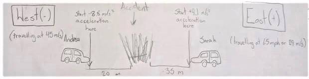

  1. Model attached below.
    1. Changed Sarah's 65 mph to m/s and got 29 m/s.
  2. Sarah's initial position is positive. Her initial velocity is negative. Her acceleration is positive; Andrew's initial position is negative. His initial velocity is positive. His acceleration is negative.

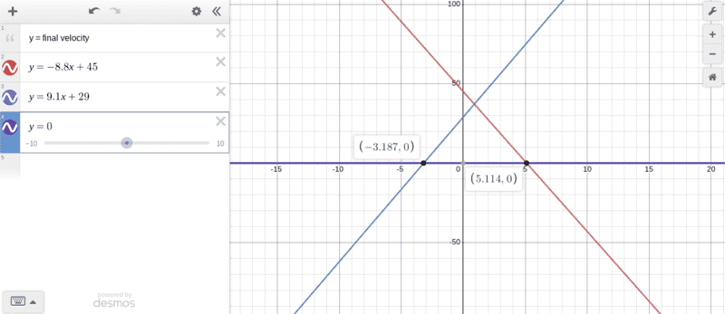

  3. Graph is attached below.
  4. Graph indicates a stopping time of 3.2 seconds for Sarah and 5.1 seconds for Andrew. (Two sig figs because measurements in initial problem were two sig figs.)

I agree with your numbers and conclusions. However your plot is not worth much without labels explaining what is what.
Likes MatinSAR
Labels for the lines? I'm a bit confused on what to label.
Label the axes with what variables including units and the lines to distinguish which of the two cars are what color. If you have plotted velocity on the vertical axis and time on the horizontal axis, then you need to explain the negative time ##t=-3.187## s which, by the way, has too many sig figs as does the other time.
It seems that you have problems with what happens when ##t =0##. Conventionally, ##t=0## is when each car starts braking. Look at the blue line. It shows that as time increases, the speed increases because the velocity is positive and moves away from zero. That cannot be because supposedly the car is braking. Both lines should start on the vertical axis and there shouod be nothing to the left of it.
By the way, the stopping distance is quickly found using the kinematic equation $$2ax=v_{\!f}^2-v_{\!0}^2.$$
Likes MatinSAR

You have given both accelerations as negative. That conflicts with what you said ealier.
You have given both initial velocities as positive.. That conflicts with what you said ealier.
valleyldp said:
Your drawing shows a large gap between the 35m and 20m lengths. There should be no gap Also, the drawing doesn't clearly show the directions for east and west vectors. Add arrows,
But the main fault is with the graph, as already been explained by @kuruman in Post #4.

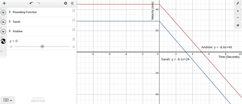

I have fixed all the things that have been suggested. My new graph is posted below. Does it look better?
Note - I couldn't figure out how to get desmos to round the x-intercept, so I just recalculated the line equations to cross the y-axis at exactly 3.2 and 5.1. Does this work?

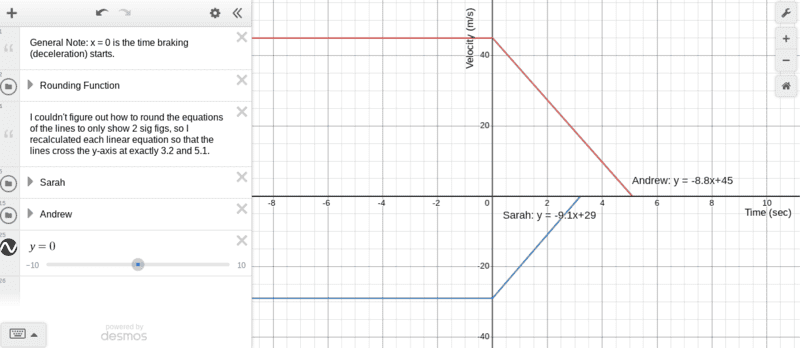

I also added the constant velocity that happened before the acceleration started.

One initial velocity is positive and the other one is negative (because the directions are opposite). But your graph shows both as positive.
One acceleration is positive and the other one is negative (do you see why?). But your graph shows both as negative. (The gradient of a v-t graph equals acceleration; the gradients of both of your lines (for t>0) are negative).
Likes MatinSAR and Lnewqban
In my model one acceleration is positive and the other is negative, but I couldn't figure out how to make a graph that would properly include both of these, so for simplicities sake I made both of them have negative acceleration and positive velocity. Do you have any idea how I could do it the correct way?
I got it I think....would it look like this?
Exactly. Good job!

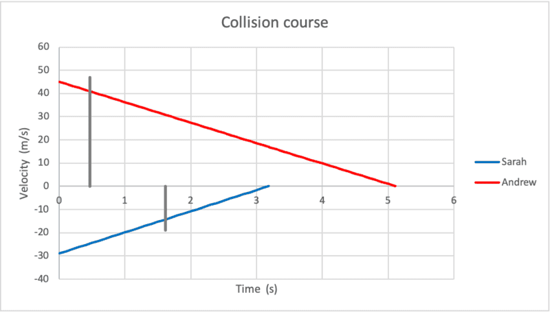

I have added the times (gray bars) when each driver collides with the pileup. Sarah will hit the pile up at about 30 mph and Andrew at about 90 mph. It looks like Andrew will take an early retirement from his job ##~\dots~## in the morgue.
