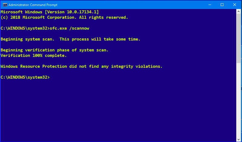

Astronuc said:
First - I used some information from here...
Did you try this one...?
