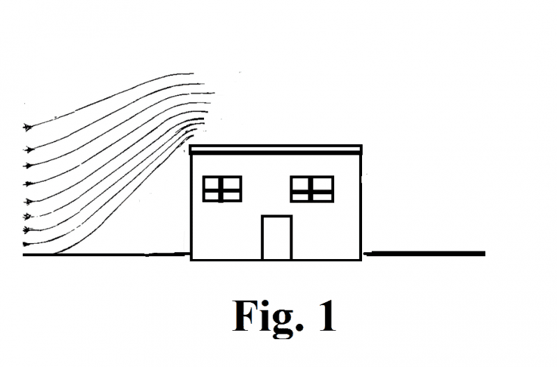

Consider fig. 1 and fig. 2 (sorry for the inaccurate drawings)
-Fig.1- Wind past a FLAT roof example
See figure 1. In books, plenty of examples and questions are given on calculation of uplift force on FLAT ROOFS of houses. WIndspeed and area of the FLAT roof is given to calculate the upward net uplift on the roof. Now if I understand this correctly, the only REAL reason for the lower pressure above roof/uplift force on a FLAT roof is because the constriction of the incoming flowing wind hitting the side wall. After this wind stream hits the sidewall, it now bends/flows up towards and around the roof where now the streamlines gets therefore closer together and reaches now a higher velocity and thus the pressure here gets lower too around and above the flat roof (all because of conservation of momentum of the initial wind velocity and Bernoulli). The flat Roof feels upward lift due to the higher indoor pressure compared to the upper outdoor air. So, the airflow-constriction i.e. the sidewall of the house is the original CAUSE for the lower pressure on the roof and thus the uplift force on the roof(?) correct? I believe so

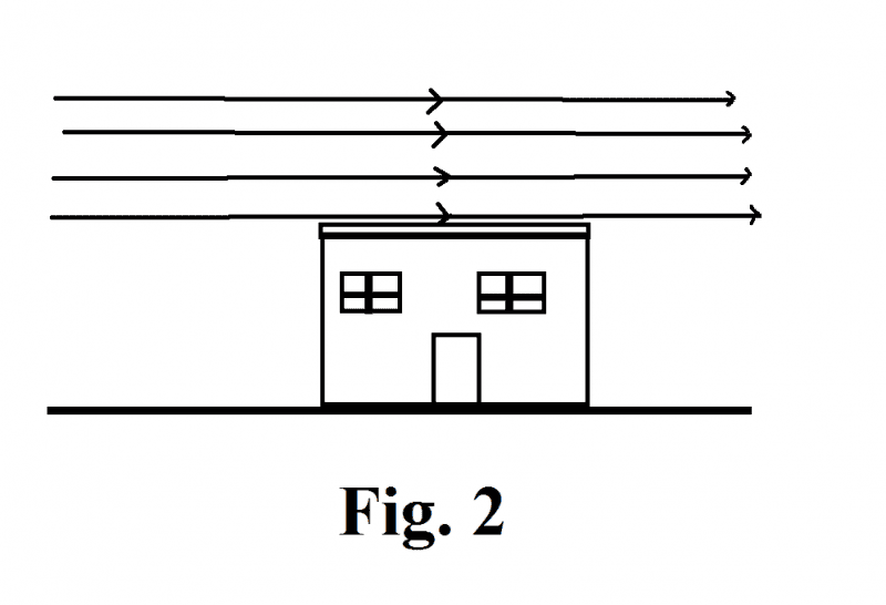

-Fig. 2- WInd past a FLAT ROOF but wind doesn't hit the sidewall i.e. no airflow constriction
To demonstrate my point, see now the hypothetical fig. 2. It is the same example as fig. 1 except now, the wind stream portion is flowing higher from the ground and is just flowing right above the FLAT roof without meeting the "sidewall constriction" or at least minimally touching the sidewall. Now in this hypothetical situation, my question is very simple: would there be a lower pressure on the roof and thus an uplift force on the roof in fig 2.? I explained this to several people and got mixed answers...
I believe that there would be no force on the flat roof in figure 2 because there is no constriction or change/deflection of airflow(?), right?
Your input is highly appreciated as I am really wanting to know. I tried some experiments but here, even slight crudeness unfortunately destroy results.

So you'd also be wondering whether the wind of a hurricane can lift man-hole covers off utility accesses in the street?

The Bernoulli effect has nothing to do with the constriction or compression of the air flowing over the wall. You are confusing the Bernoulli effect with the Venturi effect. Look at a diagram of a perfume atomizer and you will see what I mean. The flow of air down the bulb pipe flows evenly across the opening of the reservoir pipe and creates a drop in pressure on that feed pipe. The flow of any fluid across a surface (real or imaginary) will result in a drop in pressure (compared to static conditions) upon that surface. This is the drop in pressure that causes sheets of plywood to be sucked out of the beds of speeding pickup trucks, that causes the fabric convertible top on a moving car to bow outward instead of inward, that causes large boulders to be plucked from the beds of flooding streams, that causes your shower curtain to move toward the flow of water and not away from it.
Picture a standard tri-axial orthogonal reference system. Set one of these three axes as the wind axis. When the wind blows, only some of the air molecules will have a component of motion in the windward direction--albeit a majority. The others will have a component of motion in the leeward direction. The increase in total molecular kinetic energy of translation in the windward direction is greater than the decrease in the leeward direction. The difference must be made up by decreases in the total kinetic energy of translation of the remaining four axial arms. Since the total kinetic energy of translation along any axial arm and the pressure normal to that arm are rigorously related, each arm registers a drop in pressure normal to the axial arm and parallel to the wind axis. Or, as commonly stated, the flow of a fluid across a surface creates a drop in pressure upon that surface.

Sure it would. You are making a mistake here in separating a change of speed from a deflection as if they are two disjoint phenomenon. An isentropic change of speed for a parcel of fluid will always result in a lower static pressure. It just so happens that the change of speed is generally brought about by some sort of deflection of constriction. Bernoulli's equation is a statement of the conservation of energy in a fluid. Neglecting gravity, it is a statement that along a streamline (or everywhere if the flow is isentropic), total pressure is constant, or in symbols, ##p_0 = p +\rho v^2/2 = \mathrm{constant}##. For any change in ##v##, there is a change in ##p## such that ##p_0## stays the same along a given streamline, regardless of how the change in ##v## came about. Consider that ##p_0##, the total (or stagnation) pressure, is essentially the measure of the total energy density in the fluid. ##\rho v^2/2## is the kinetic energy density in the fluid as a result of the bulk fluid motion, and ##p## is like a spring potential energy density in the fluid. In order to conserve the total energy, if you increase the kinetic energy of the flow by increasing the speed, the potential energy goes down.

The problem here is that this explanation in that thread is incorrect. Bernoulli's principle certainly does apply on the roof of a car. The problem with that thread is that it has nowhere near enough information to answer the question.

The problem here is that the air in the house and the wind don't necessarily originate in the same reservoir condition. You might be sitting in your nice, air-conditioned house, while the wind outside is being generated by this gigantic heat engine that is a hurricane. Houses are not air-tight, so over a long time the pressure will tend to reach equilibrium with that outside, so if you have a very gradual decrease in external pressure over the course of a lengthy storm, then there are probably no issues as the inside air and outside air would be at (or nearly at) the same static pressure. On the other hand, that isn't likely the case for a gust of wind that comes on rather suddenly.
The problem then goes back to that of the uncommon reservoir. There is nothing to suggest that total pressure should be conserved inside a house and outside of it, so you can't just apply Bernoulli's equation using the pressure inside the house and the velocity over the roof to find the pressure over the roof. If you think about it, the pressure inside your house is already standing essentially still and is at a total pressure that equals the ambient pressure inside your house. On the other hand, if you go stand outside in the hurricane and put your hand out so that it stops the wind, the pressure you feel on that windward side of your hand is the total pressure and is very likely higher than the ambient pressure (and total pressure since the air is stagnant) in your house.
A similar situation is the bogus Bernoulli's principle explanation of why a sheet of paper lifts when you blow over it. You can't use Bernoulli's principle there because the air under the paper is still and has a total pressure that is different from the air going over the top since that moving air originated in your lungs and its reservoir was therefore pressurized to a higher total pressure than ambient when you started blowing. The paper lifts because the added pressure from your lungs is still rather small, so if you apply Bernoulli's equation from the point the air starts in your lungs to the point it moves over the paper, the static pressure is still going to be a bit lower than ambient so you get lift. Once again, though, you can't combine the wind velocity there with the pressure under the paper that didn't originate at the same reservoir condition as the moving air. It doesn't work that way.
So then the question is, given the pressure inside your house, what is the pressure over the flat roof for a given outside total pressure and wind velocity. The end result may well be that the flat roof (or a manhole cover) gets sucked off, but the common explanation using Bernoulli's equation with the inside and outside pressure is wrong. The same concept applies to the manhole cover.

It could but that doesn't mean it necessarily will. It all depends on what the pressure on each side of the manhole cover is at a particular point in time, and the two are not necessarily easily related through a relationship like Bernoulli's equation since they don't originate from the same total conditions. Moving air can produce a force over a manhole cover, though. I hate to cite Mythbusters, but they did an episode where they looked at a race care driving fast over a manhole cover, and while they certainly didn't lift the cover off the road, they were able to measure a force on the cover. It isn't perfect science, but it should serve to illustrate that moving air over a flat surface can result in a lift force, but it isn't necessarily due to Bernoulli's principle since the moving air has had energy added to it beyond the air beneath the flat surface in these sorts of cases.

Within reason, no lift. The assumption is that the static pressure within the flow is the same as the pressure below the manhole cover.
