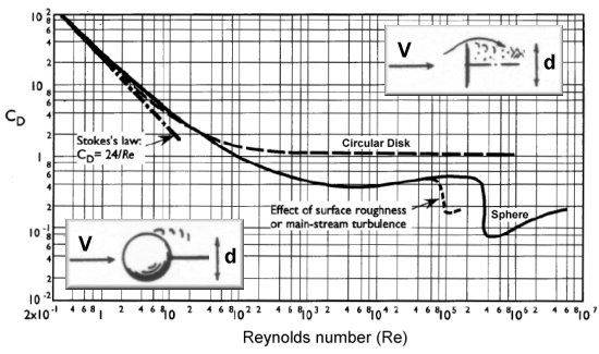

Below a certain Reynolds number (like ~ 3000), the drag becomes Stokes Law for non-turbulent flow.

"Much lower" is meaningless. If Cd is flat over a wide range of Reynolds numbers, then being an order of magnitude lower in Re than the full scale vehicle doesn't matter.
The point is, there is a range of Re you want to be in for certain vehicles. Once you go outside this range, the sensitivity to Re increases substantially. For most aircraft, 0.6< Re < 2 million is a good range to be in for testing.
Turbulent flow does not imply that you have separation bubbles, or that you are more likely to have them. Designing a new vehicle is tough because the use of trip strips is based on where you *think* the full scale vehicle will have separation. This is usually done by the tunnel engineer who has experience working with many aircraft models.
Higher angles of attack usually are better because the transition point moves forward, so less of the wing has laminar flow (which is where you are guessing it occurs when you use trip strips). It's lower angles of attack that comparison is not as good since you are using trip trips to guesstimate where transition is going to occur.
You should also look up a plot of Cd Vs Re.
