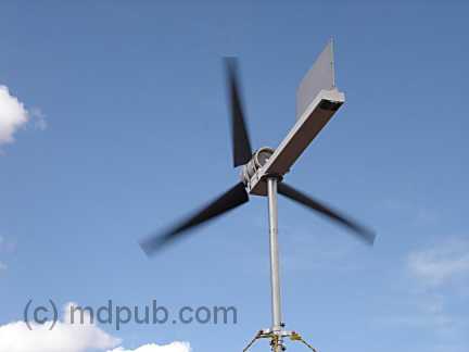

I recently read this http://www.earthtechling.com/2011/0...ng+(EarthTechling)&utm_content=Google+Reader" and it's really bugging me.
They claim that by putting wind turbines on the prow of the ship they'll harvest energy from the wind but also, that the air resistance will decrease and so the fuel consumption will be lowered.
No doubt that the air hitting the boat will be less strong (because the wind turbines "trap" its energy) but what about the air hitting the windturbines? Aren't they just claiming this?:
[PLAIN]http://input-image.info/physics-troll/1285635805554.jpg
My assumption had always been "if you put a wind turbine on a moving vehicle, the energy delivered by the wind turbine will always be less than the extra energy you need to move the vehicle bacause of the drag produced by the wind turbine". Am I wrong?
All this leaving aside the fact that the air resistance is not that important in these vehicles I guess. It's the water resistance which matters, hence, the shape of the boat under and above the sea.

"The turbines will be located on 4 meter high masts on the front of the ship and not only produce 23,000 kWh per year, but also reduce air resistance. The electricity will be used, among other things, to light up the car deck. The reduction in air resistance will lead to reduced fuel consumption of about 80-90 tons a year."​
I don't really know about VAWT (vertical-axis wind turbine) but I do know that the axial forces on a HAWT (horizontal-axis wind turbine) are much bigger than those moving the blades. One just have to look at a wind turbine blade to notice how do they bend. However, the WT's on this ship are HAWT and I don't really know the aerodynamics involved on this type of turbines.
I have to clarify though, that I'm not saying they're wrong. I understand that there's a team of much more experienced engineers than me behind that project. I'm just looking for an explanantion.
koko, in general you are correct that putting a wind turbine on a moving vehicle generally increases wind resistance. However, there are potentialy limited cases where it may reduce it. The ferry has a big flat front to its superstructure that is about as bad as you can get, while the turbines are smaller and may have the effect of directing air around the superstructure. I'm skeptical that it would be worth the money to put them there, but this sort of thing is very tough to predict without a wind tunnel.

I see your point about the massive flat front of the boat. I thought the same but still doesn't make 100% sense to me. As you said, i would need to see it in a wind tunnel. Anyway, aerodynamics never make sense to me ever since I first learn the Venturi effect. It's just faith! ;)
