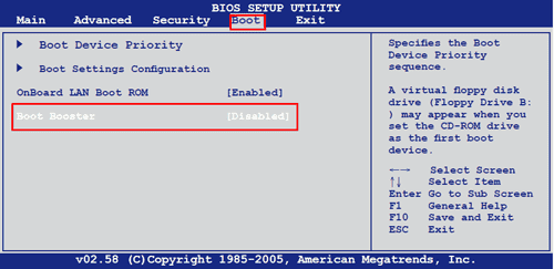

1. Exactly what did it do when you tried F9 (assuming you tried pressing f9 during the Asus splash screen immediately after power on)? Have you tried powering down, then pressing and holding F9, and while continuing to hold F9 down, powering up, without releasing F9 until something past the Asus splash screen happens?
2. If the answer to 1 is "nothing", have you tried F2 (BIOS setup) or F8 (to get to Safe Mode) or F10 (to allow boot from another device) and if you have, with what results?
If you can get to BIOS setup via F2, try turning off Boot Booster (if it's there on your machine), and then save settings, power down, and try F9 during power up again:

sysprog said:
F2 didn’t work, bc no boot booster shown under boot section.
