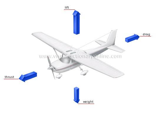

Flying, after all, is a dynamic activity. Planes just don't jump off the ground by themselves.
This diagram shows the basic forces acting on an aircraft in flight:
