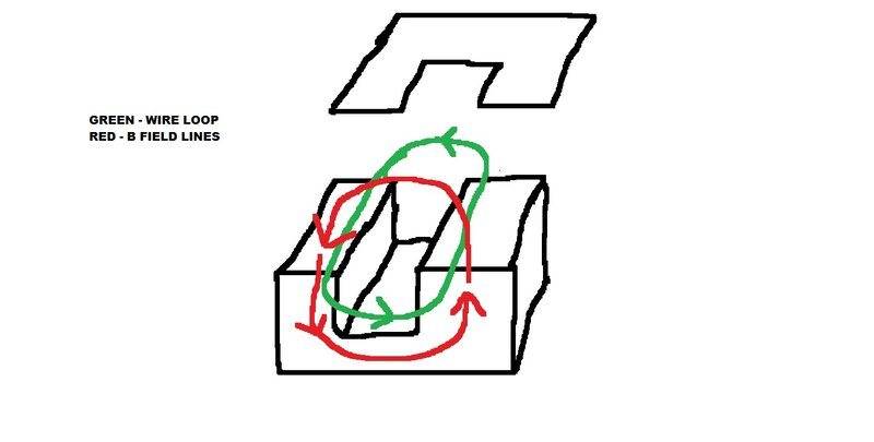

Ok , I understand what you are saying and in theory this should work like that, let me show a simple picture that I made to maybe better illustrate what I am saying.
See there is a rectangular iron core sliced in half much like a transformer, now say that one part of the iron core has a coil on it so that there is a magnetic field produced in the core, the B field lines (shown in red) loop around the core as shown.
Now the core has an airgap in the middle where a circular wire loop is inserted (shown as green) Now imagine we take the whole iron core together with the loop and either rotate around a fixed axis or it moves with some speed in a straight line like in a linear motor.
The B field is such that the wire loop has B field lines coming from opposite directions at opposite sides in order to satisfy the difference in current directions.
Now my question is this would there be current generated in the wire loop if it moved together with the iron core through space (the wire loop itself stays fixed in between the iron core at all times)

girts said:
Now my question is this would there be current generated in the wire loop if it moved together with the iron core through space (the wire loop itself stays fixed in between the iron core at all times)View attachment 225650
No.

you say there should be no current, but we are not talking about induction but about Lorentz force, in a Faraday disc since the B field is static and homogeneous it does not matter whether the magnet rotates or not , all that matters is for the conductor to rotate,
now imagine this drawing from such viewpoint, see that each of the two parts of the wire loop passes along the side of the sliced iron core, (the iron core can be extended to engulf each halfwire more completely than shown in the picture but that is a detail) so each half of the complete wire loop is situated within a B field that is perpendicular to the wire cutting it, one half is cut from bottom up the other half where the flux returns is cut from top to bottom, so that the current adds in each half,
given this explanation why do you think there would be no current if I simply rotated or moved the whole assembly?
I said it about situation that were on your image.Sum of forces to charge carriers in wire on that picture is 0 if the wire moves along with magnet with constant speed.
