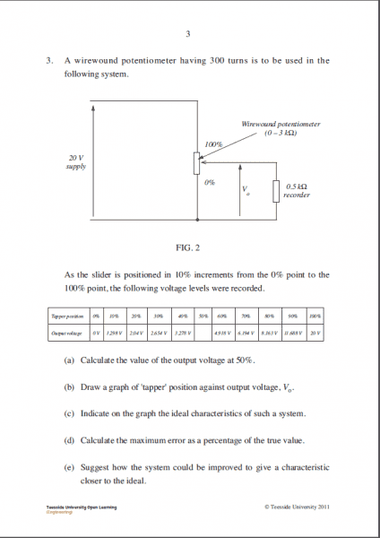

A Wirewound potentiometer having 300 turns is to be used in the following system (see atached question file)
See attached coursework file
Unsure where to begin. I have converted the circuit in the attached file to a Thévenin equivalent circuit but I'm unsure what figures to use for my Rt when the tapper is at 50%. Would i be right in saying that for the 50% tapper that x would equal 0.5 so (1-x)Rp would be (1-0.5)3kΩ and xRp would be 0.5x3kΩ both equalling 1.5kΩ.
Its the equations for working out the non-linearity which you can see on pages 19-21 of the attached learning material that i cannot follow. Any help would be greatly appreciated.
I have attache two files, one is the question and the other is the learning material given regarding the question.

What are you planning to do with the 0.5 kΩ?
I am unsure on which equation I should use, the equations on pages 19 & 20 are obviously the route I should be taking but I'm unsure of where to begin. I attempted to use Vactual = Vt x RL / RL + RT and I got a figure of 5v but this is obviously the linear figure. So do I simply take x as 0.5 and input it to the following equation N(x)=-Vs x (x2(1-x)/ RL/Rt + x(1-x) along with the figures for Vs, RL and Rt?
You have a single, adjustable resistance between the tap and the 20 V source that is in series with two resistances that are in parallel. What is the resistance of the two resistances that are in parallel? What is the total resistance when that is in series with the single resistance?
Parallel resistance is Rt= R2xRL/R2+RL? Series resistance Rt= R1+R2 so parallel Rt= 1.5x0.5/1.5+0.5=0.375 series =1.5+0.375=1.875
I=v\r 20/1.875= 10.67 Vout = Ixr = 10.67 x 0.375= 4.00125v @ 50%tap? Am I miles off?
Looks pretty good. A note on your notation and units: be careful when you're "dropping" the "k" on kΩ and switching to mA rather than A for current; if you go ahead and write those units in, you won't find yourself in trouble with more involved problems where it's easy to lose (or gain) three orders of magnitude in your answers.

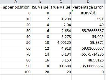

I've had to create a graph of tapper % position v output voltage, it's now asking me to calculate the maximum error as a percentage of he true value. Can i simply take the 2/3 position and calucate the error there with respect to true value?
Without doing the math, "that will be left as an exercise for the reader," (how many times have you had that in your face?) it's not obvious that maximum non-linearity is coincident with maximum error. You'll want to set up ideal Vout for no load (infinite resistance across divider output), x or (1-x) times 20 V minus Vout for the 500 ohm load over ideal Vout, and differentiate that with respect to x, looking for its maximum.
So taking the figure i have the maximum error comes out at 50% so i understand that the max error does not coincide with max non-linearity. See attached image. I also understand that there is a point between 50% and 60% tapper position wherer the error will be it's max but I'm unsure how to find the maximum like you've explained above.
The original question just had you doing every 10%. So, presumably that's all they want.
The second derivative of the function I just had you construct will be zero at either maximum or minimum error if you want to pin the error max down exactly.
I'm confused with your above post. If I've calulated that at 50% tapper the error is maximum @ 59.9875% why do i need to do a differentation for x?
