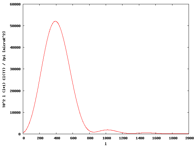

I presume it would not alter Big Bang theory, or the predicted age of the universe, or anything else really except for the noted experiments. There would be a problem with the Lambda-CDM model, but only really on the content of the universe part. I can also see a problem with the attempt to *make* a result we want in order to make the universe flat, to agree with the CMB evidence that it is. But, what exactly would be the problems for this particular problem. Could the universe be flat without the 25% and 70% extrapolations of DM and DE?
Sure we could make a flat universe just out of baryons, just by putting in 20x more baryons. But there are plenty of problems. If we keep Ho around the same, the universe would only be about 9 Gyr old instead of 14 Gyr old, which would disagree with globular cluster ages. Constraints placed by BBN would be violated. The CMB would look like this [attachment 1] instead of this [attachment 2]. (Source: CMBFAST online tool http://lambda.gsfc.nasa.gov/toolbox/tb_cmbfast_form.cfm )
It seems that there would not need to be that much extra baryons if there were no negative energy from dark energy and no dark matter... remember, dark energy must be set to zero.
Can you explain why this would make the big bang 9 billion years ago instead of 14 billion years ago?
And I am sorry, but there is no way that the CMB is just that simple.
What BBN constraints and why must H0 remain constant?
Also, what is the '5th dimension' mentioned in this calculator?
I don't know why you think dark energy has negative energy. It is most certainly positive energy. Maybe you're thinking of negative pressure.
The formula for the age of the universe, which comes from a basic analysis of the Friedmann equations, is
[tex]T=\frac{1}{H_0}\int\frac{da}{a\sqrt{\Omega_{\Lambda}+\Omega_{m}a^{-3}}}[/tex]
If you put in the numbers it just happens to give 9Gyr instead of 14Gyr. In fact, one of the original reasons people wanted to introduce dark energy was to make the universe old enough to account for the ages of some globular clusters.
It's your own prerogative to disbelieve these CMB graphs, but you're free to try to reproduce them yourself. Keep in mind that CMBFAST is a well-respected program that professionals cosmologists use all the time. I'm not sure what the "5th dimension is", and I would ignore it.
I don't have my cosmology books on hand, but I'm pretty sure BBN puts some fairly strong constraints on what the photon-baryon ratio has to be. Certainly strong enough to prevent you from increasing the number of baryons by a factor of 20.
I suppose if you want to make the universe flat without DE&DM, you could shrink the Hubble constant by a factor of sqrt20, down from 72 to 16. Of course this is highly inconsistent with all observations, but I guess no more so than increasing the number of baryons by a factor of 20. If that was the case, the universe would now be a rather absurd 41 Gyr old.
