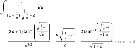

When I put the following integral into the free version of Wolfram I get a sensible answer:
$$\int \frac{1}{(1 - \frac 1 u)\sqrt{\frac 1 u - a}}du$$The function includes an inverse ##\tanh## function that (as expected) diverges as ##u \to 1##. But, if I try:
$$\int \frac{1}{(1 - \frac 1 u)\sqrt{\frac 1 u - \frac 1 a}}du$$I get a much more complicated result without the inverse ##\tanh##, which appears not to diverge as ##u \to 1##.
The moral is, I guess, even simplifying a single parameter can make things easier for the engine.

Suprisingly the derivatives of those functions are the same:
$$\frac{d}{du}\bigg (\frac{2 \tan ^{-1}\left(\frac{\sqrt{\frac{1}{u}-a}}{\sqrt{a-1}}\right)}{\sqrt{a-1}} \bigg ) = \frac{d}{du}\bigg (-\frac{2 \tanh ^{-1}\left(\frac{\sqrt{\frac{1}{u}-a}}{\sqrt{1-a}}\right)}{\sqrt{1-a}} \bigg )$$
When Wolfram produced the version with the second ##\tan^{-1}## function, I thought it must be wrong, as I needed the ##\tanh^{-1}## to convert to a log function.
It took me awhile to figure out how it diverged. When ##u=1##, the argument of the second arctan is equal to ##i##, and apparently, arctan has a pole there. I never knew that.

Of course, the functions apply to different regions. The LHS is valid for ##a > 1## and the RHS for ##a < 1##.
