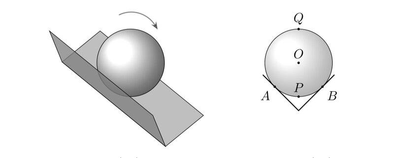

Two rectangular pieces of metal are joined at right angles, forming a guide with two surfaces, which is then tilted at an angle ##\alpha## . A wooden ball descends down the rail, rolling without sliding. The figure shows the image from the side, and then from the front, viewed from below.
1.) Which point on the surface of the sphere has maximum instantaneous velocity?
2.) If ##v## is the speed at which the sphere falls, what speed does that point have?
3.) What is the minimum value of the coefficient of static friction between metal and wood?
Figure: https://imgur.com/tWy7d2n
edit: {See included figure at bottom}

The acompanying figure?
Likes Chestermiller
I put it in, editing the "Homework statement".

[edit: okay, now we have an image, ##Q##, right : also, it seems reasonable to assume that "from below" actually means "directly in front"]
2. Your assumption that ##V_Q = 2v_{trans}## is based on an incorrect assumption of how the ball is rolling . . . along the V-shaped track.
(As an aside, I'm assuming the question means by "falling" to be moving along the track, and not vertical displacement)
3. Kneejerk reaction says that the contact area is ##0## so there's no way of telling, so I guess my math/physics isn't immediately up to the task.

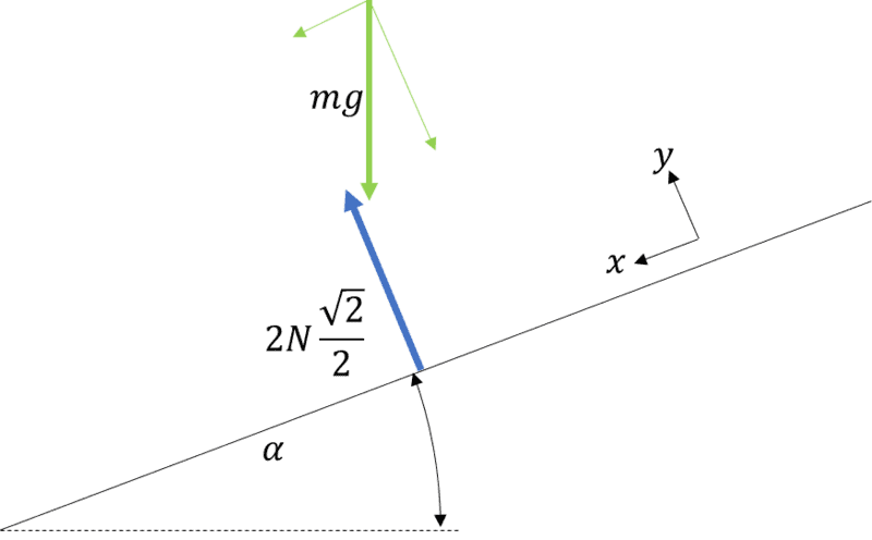

Hak said:
Sum of forces perpendicular to track: $$2N - mg cos \alpha = 0$$
I don't think that is correct. Draw Normals is the front view, resolve them into components then further resolve those components into components in the sideview.
I don't think I understood correctly. Could I have some hints?

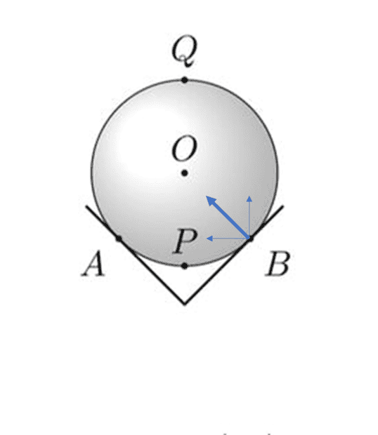

Think about the direction of the Normals in 3 dimensional space. When you are looking from the side view are you seeing the true length of the vector or the projection of the vector onto the viewing plane?
Obviously, the projection of the vector onto the viewing plane, but I cannot express it in physical formulas. Should I also consider the horizontal component of ##N##?
Draw Normals in the front view. It is the vertical component of the Normals in the front view that is balancing the forces in the side view, not the entire magnitude of the normal vectors.
So, is ##2N cos \alpha = mg## correct?
No, look at the front view, i.e. the view on the right of the image you attached. Draw the Normals in that view.
I have ##N_A = mg cos \alpha## and ##N_B = mg sin \alpha##. So?
The vertical components of the normal forces in this picture. They are what balance the component of weight perpendicular to the incline in the side view.
Why did you only consider the normal force in ##B##? Sorry to bother repeatedly...
I didn't. That was just an illustration of what I'm talking about. Do you understand what I'm saying about this whole normal force business yet?
I don't know if I understood. I would say ##N (cos \alpha + sin \alpha) = mg cos \alpha##. Is it correct?
Hak said:
I don't know if I understood. I would say ##N (cos \alpha + sen \alpha) = mg cos \alpha##. Is it correct?
Sorry, you aren’t seeing it yet.

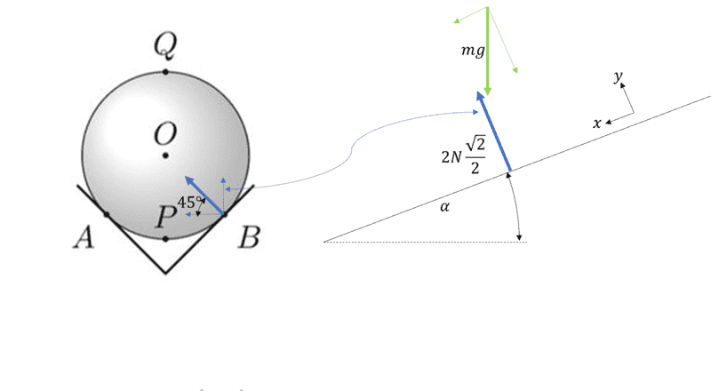

  • #31
I don't know how to do it. You said that the vertical components of the normal forces must balance the perpendicular weight ##mg cos \alpha##. So, what is wrong in my equation should be the expression of ##N##, right? Would you have more in-depth hints on how to write it?
  • #32
Hak said:
I don't know how to do it. You said that the vertical components of the normal reaction must balance the perpendicular weight ##mg cos \alpha##. So, what is wrong in my equation should be the expression of ##N##, right? Would you have more in-depth hints on how to write it?
The component of weight is in the plane of the page. The normal force is pointing into the page at a 45 degree angle. It is only the component of ##N## parallel to the plane of the page which balances the component of weight...not the entire magnitude ##N##.
  • #33
Yes, you're right. ##N \sqrt{2} = mg cos \alpha## is correct actually?
  • #34
So, is the correct solution ##\mu_{min} = \frac {2 \sqrt{2}}{9} tan \alpha?##

  • #36
No. Where does ##\cos\alpha## come from? Look at the picture in post #26. Points ##A##, ##B## and ##O## are all in the same plane. In that plane are also the normal force vectors and the weight.
  • #37
That comes from the balance of forces along the incline.
  • #38
So, I would say ##N \sqrt {2} = mg##. Correct?

On the left we are looking up the incline. I'm not drawing to scale, and I didn't draw the other normal force.
  • #44
Thank you so much, it seems correct. I did not understand, therefore, @kuruman's answer...
