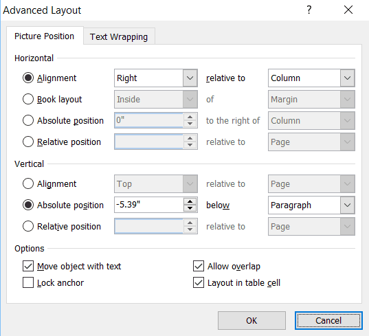

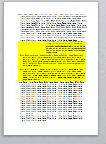

The yellow box is a canvas. The only way I can get it outside the margins is by resizing it.

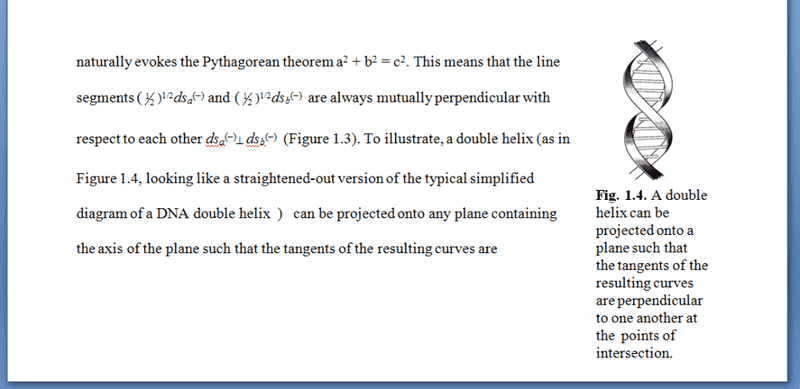

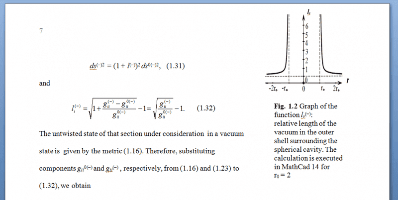

Thanks, BvU. I will give you two examples, but first I will note that I don't have 2010 prof plus, just the ordinary Word 2010. So, first, one that breaks the margins above, another which breaks the margins below (the two examples got squished together; they are not really on the same page):
Your picture doesn't help much -- it's a picture. Don't see margins, don't see how you break off the text to leave room for the pictures, etc.etc.
But I suppose you want the Figure 1.2 to move down and 1.4 to move up. Preferably automatically when you add more text to the caption ?

Ah, sorry, I thought it was obvious that the upper margin was on the same level of Equation (1.31), Figure 1.2 is configured as "square" in the list of Wrap Text, and goes annoyingly up to the top of the page; similarly, the lower margin is on the same level as the last line ("...tangents of the resulting curves are"), and Figure 1.4, also with "square"-wrapped text, goes annoyingly down to the bottom of the page. The shapes can be positioned, with a bit of fiddling with positioning of the text, to be between the margins... until the next change in the text, which could then end up with the Figures (which are canvases containing one picture and one text box each). So one way to solve it is wait until the text is finalized and fiddle with the text at the end to position the canvases correctly, but I have quite a few canvases and would like them to adjust themselves without this hassle, just as the text adjusts itself to stay within the margins. In other words, I would like the figure to automatically go to the next page if the text pushes it too down, or to adjust the text wrapping it the text is trying to push it too far up. Alas, I don't have VBA and do not know how to work with it if I had it, but as I say, nudging the pictures is not the problem. I can do that, but imagine if you had to manually adjust the text to make sure it stayed within margins. (Ah, remember typewriters?)
Yes it's obvious, but I can't dig into see how the Word objects are arranged.
What I conjectured in my previous post is a little different. So the main text is what varies.
That's a tall order: programs are good at doing what you tell them, they are not good at reading your mind.
Perhaps it helps if you know a bit more about the workings of Word. In paragraph, on the Home tab, top right, " ¶ ", you can make some extra formatting symbols visible. An inline Shape has an anchor to keep it near the related text that becomes visible when the shape is selected. Anchor text moves ##\Rightarrow## shape moves.Parameters are in Right mouse button | More Layout options.
At least now I can reproduce your problem (see file)
Perhaps there is a way to improve your situation. But: Your problem arises when the anchor text comes closer to the top or the bottom of the page and I think it is hard to detect this without VBA coding. Let alone fix it (If you do it by hand you make seemingly trivial choices)
