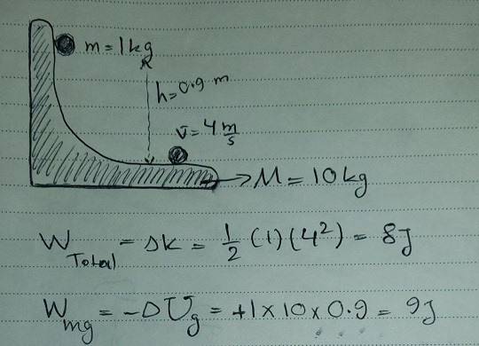

An object descends from the rest state from above the surface and goes to the right And the surface goes to the left due to the object coming down(Friction between object and surface and friction between the surface and ground are both zero). What force causes the surface to move to the left? 1 joule of negative work is done by what force?
W=K2-K1
Can I say that it's due to the force component of the weight along the vertical force of the surface?

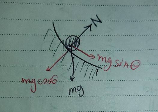

I made a mistake. I will correct: The force that the body exerts on the surface due to its weight has two components: perpendicular to the surface and parallel to the surface. Does this vertical component cause the surface to go to the left?!
Lnewqban said:
Only its horizontal component at each instant.
So is it true to say this vertical component cause the surface to go to the left?!
MatinSAR said:
I don't know why I have repeated my mistake ... sorry ...
I think that you meant to say that the normal force of ball on surface can be regarded as having a vertical component and a horizontal component.
The vertical component acts vertically. It does not cause the surface to accelerate to the left. It would cause the surface to accelerate down into the table below. The table below prevents this acceleration.
The horizontal component acts horizontally. It does cause the surface to accelerate to the left.

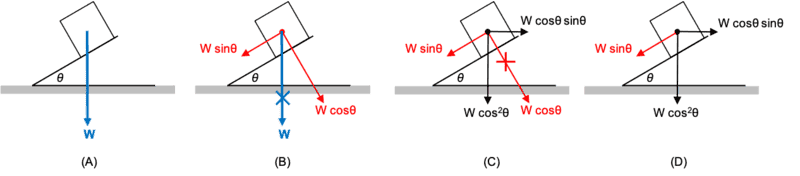

And here is how the weight provides the accelerating force.
(A) The weight (blue arrow) is straight down.
(B) The blue weight is resolved into two red components, one perpendicular to the surface and one parallel to the surface.
(C) The red perpendicular component is further resolved into two black components, one horizontal and one vertical.
(D) The original single blue vector representing the weight is the same as the sum of three vectors: one down the incline, one vertical and one horizontal. The horizontal component accelerates the incline; the vertical component is cancelled by the normal force exerted by the surface; the down the incline component accelerates the block.
Disclaimer: This is not a free body diagram of the block. I omitted the normal force exerted by the incline on the block for clarity.
Likes PeroK, erobz and Lnewqban

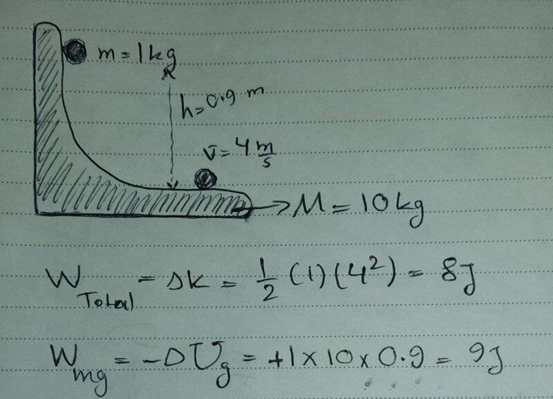

By the way, the solution you posted in the photo, post #1, is incorrect. You omitted the kinetic energy of the sliding ramp that has mass 10 kg. What do you need to do to find how fast the ramp is moving when the block reaches the bottom and is moving horizontally?
Likes erobz and MatinSAR
First, we find the total work done on the object. (Total Work is 8j)
Then we calculate the work of each force on the object.
Two forces act on the object :
1) Gravitional force : W = mgh = 9j
2) We know that there is a horizontal force that the object applies to the surface and causes it to accelerate to the left. According to Newton's third law, the surface exerts an equal amount of force on this object in the right direction, but since the force is opposite to the displacement direction, the work of this force is negative.
So work of this force is -1j ... ( Reason : Wmg + W2 = WT )
I think this is the reason for that negative work ...
I think that the object also does the same amount of work on the surface, but since the direction is the same, the work is positive and the total work done on the surface should be 1j ...
K2 - K1 = 0.5(mv^2) => 2=10v^2 => v= 0.447 m/s

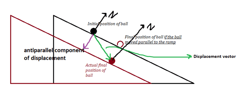

Hint: You have calculated the net work done on the ball in the first post as well as the work done by the gravitational force acting on the ball. What other force does work on the ball?

Concentrate on the ball rather than the ramp. What are the individual forces acting on the ball?
You calculated the net work done on the ball in your first post. This net work on the ball must equal the sum of the works done by the individual forces acting on the ball.
  • #31
Any kind of air resistance and friction is ignored. Do you mean another force?!
mg and N.
  • #32
MatinSAR said:
mg and N.
OK.
What is the numerical value of the work done by mg on the ball?
What is the numerical value of the total work done on the ball?
What can you deduce from this concerning the work done by N on the ball?

9 J
8 J
-1 J
But the work done by N must be 0, isn't it perpendicular to the direction of movement?

For a small time interval, you will need to imagine the displacement of the ball. Does this displacement have a component parallel or antiparallel to the normal force acting on the ball?
  • #39
N is neither perpendicular nor parallel to displacement.
As the object descends and the surface moves to the left, the object tilts slightly downward and does not move parallel to the surface.
Am I wrong?!
  • #40
As the object descends and the surface moves to the left, the object tilts slightly downward.

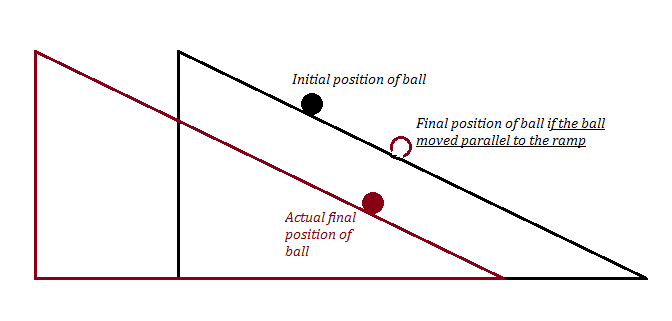

But does the displacement of the ball have a component parallel (or antiparallel) with N?
The picture below shows a small interval of time with initial time in black and final time in brown for the case of an inclined plane for the ramp.
If the ball were to move only parallel to the plane, then it would end up at the position shown by the open circle. But the ball must end up on the brown ramp. The overall displacement of the ball is from the intial black position of the ball to the final brown position of the ball.
Likes Lnewqban and MatinSAR
  • #41
antiparallel ??
  • #42
Yes. Good. So, do you see how N does negative work on the ball?
  • #43
N and one of the displacement components are in the opposite direction, so the work is negative.
Is it true ??
  • #44
Is it true ??
Yes.
