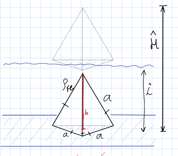

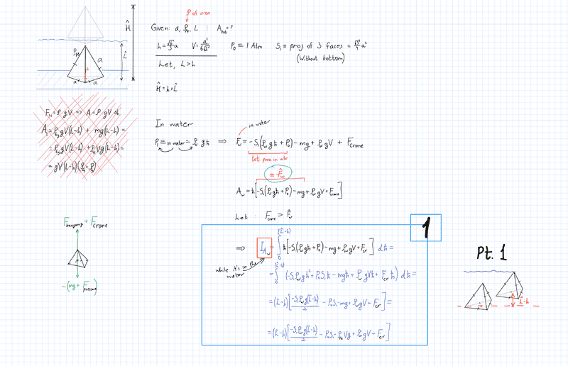

Hi, I'm calculating the work done by regular tetrahedron during taking from the water by crane (USING INTEGRALS). I don't know how bad is that solved so if anyone checks my work and gives me some advice or hints I would be very glad.
Everything is written in the PDF file.
There were given:
Tetrahedron side - "a";
Water depth - "L";
The density of iron (tetrahedron material) - "rho (Fe)".
I assumed the density of water and the pulling force of the crane.
Also, I divide the problem into two parts, the first is the work done before it came out from the water, and the second one is starting to come out from it.
  • Calculate A.pdf

But can you post the original question in full as an image, not a pdf?
Is it a solid tetrahedron of iron, initially resting with its base at depth L, fully submerged, then raised until just clear of the water?

Yeah, I've tried that help page but, still couldn't do that.
Here're the images.

I would just calculate the submerged volume of the tetrahedron as a function of height which would allow me to calculate the buoyancy. It seems like you are doing more than this.
Yes, the main question is to find the full work done by taking this object out from the water.
Don’t you then just have to integrate the sum of the force of gravity and buoyancy force?
I did that, mg, buoyancy, pressure, and crane (imaginary) forces. I don't know if those are correct, that's why I'm posting.
There are three regions: 1) fully submerged, 2) partially submerged and 3) above surface. Let M,V be mass, volume of tetrahedron; h1, h2,h3 be distances lifted in each region. Buoyancy is technically an equilibrium phenomena so we are moving infinitely slowly.
Region 1) ##W_1=(M-\rho V)gh_1##
Region 2) let v(h) be the submerged volume
## W_2=Mgh_2-\int_0^{h_2}\rho gv(h)\,dh##
Region 3) ##W_3=Mgh_3##
The total work is ##W=W_1+W_2+W_3##. You seem to be doing more than this. I am on an iPad, so your image is too small to read.
The above statement suggests you may be ‘double counting’ the force of buoyancy.
An object’s buoyancy is a result of pressure differences. For a simple illustration, find the buoyancy of a fully immersed cube in two ways:
a) use the fact that it equals the weight of fluid displaced;
b) use the fact that it equals the net force due to the different pressures on the top and bottom faces.
They are the same quantity!
Also, in the limiting case of raising the object very slowly (so kinetic energy is negligible). the external lifting force must equal the vector sum of the weight and buoyancy. So you need to integrate only two forces.
(Apologies if you are already aware of the above!)

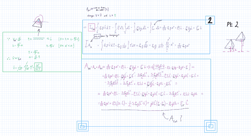

Just recalculated and fixed the latex :)
Given: $$a, \rho_{Fe}, \hat{L}, \quad A_{tot}=?$$
h=\frac{\sqrt{6}}{3} a \quad V=\frac{a^3}{6 \sqrt{2}} \quad P_0 \equiv 1 \space atm \quad S_1 \equiv projection \space of \space 3 \space faces
Let L > h.
1) Then the work done in the water before its highest point touches its surface is:
I_{A_{water (w)}}=\int_0^{(\hat{L}-h)} h\left[-S_1\left(\rho_{w}g h+P_0\right)-m g+\rho_{w} g V\right] dh=(\hat{L}-h)\left[\frac{-S_1 \rho_{w} g(\hat{L}-h)}{2}-P_0 S_1-\rho_{Fe}g+\rho_{w} g V\right]
Work done by the bottom part (inside the water) of the tetrahedron:
Buoyancy force:
Let V̂ = how the volume depends on the height of the tetrahedron.
So, $$
h=\frac{\sqrt{6}}{3} a, \quad a=\frac{3}{\sqrt6} h, \quad V_{volume}=\frac{a^3}{6\sqrt{2}}
\hat{V}=\frac{1}{6 \sqrt{2}} ({\frac{3}{\sqrt{6}}})^3 h^{3}=\frac{3 h^3}{8 \sqrt{3}}
I_{A_{Buoyancy}}=\int_0^h \rho_w g \hat{V} dh=\rho_{w} g \frac{1}{8 \sqrt{3}} \int_0^h h^3 dh=\rho_{w} g \frac{h^4}{32 \sqrt{3}}=\frac{9}{128}\rho_w g a^4
2)
I_{A_{bottom}}=\int_0^h \rho_w g V dh-\int_{S_1}^0 P_0 d S_1 \int_0^h d h-\int_0^h \rho_{Fe} V g d h = \frac{9}{128} \rho_{w} g a^4+P_0 S_1 h-\rho_{Fe} Vg h
3) Work done by the top part of the object (after crossing the surface of the water):
I_{A_{top}}=-\int_0^{S_1} P_0 d S_1 \int_0^h d h-\int_0^h \rho_{Fe} V g d h=h\left(-P_0 S_1-\rho_{Fe} Vg\right)
4) Total work:
Because at this point S₁=S, then
A_{tot}=\frac{9}{128} \rho_{w} g a^4+P_0 S(h-\hat{L})-\frac{1}{2} S \rho_{w} g\left(\hat{L}^2-h^2\right)+g V \hat{L}\left(\rho_{w}-\rho_{Fe}\right)-V g h\left(\rho_{w}+\rho_{Fe}\right)
What about now?
You have presented things in a unclear way
1) It is not clear from the problem statement where the bottom (or top) of the tetrahedra is at the beginning and end of the problem
2) You should not use a and h. I would suggest h.
3) Buoyancy is caused by the pressure differences so you are double counting (@Steve4Physics said this in post #12). I would suggest using buoyancy not pressure differences.
4) The P0 term in the solution is wrong.
5) What is the difference between I and A?
6) This thread has a lot of posts. Focus on what was said in 11 and 12.
7) Try telling us what you are doing step by step. It will be easier than trying to correct your equations.

The first part would be this?
A_w=\int_0^{(\hat{L}-h)}\left(\rho_{F e}-\rho_w\right) V g \space d h = (\hat L-h)(\rho_{F e}-\rho_w)Vg
Where L-h is:
If the bottom of the tetrahedron is L beneath the surface at the beginning, this is correct.

@NODARman. in addition to what @Frabjous has said, please note that you appear to be using the same symbol “##h##” for two different quantities:
1) the fixed height of the tetrahedron, a constant;
2) a variable distance (e.g. when ##dh## is used for integration).
This causes confusion!

Here’s a hint. Vsubmerged=V0-Vabove water

Maybe I misread the above posts, but IMO the buoyancy (from Archimedes principle) needs to be ## \int \rho g \,dV=\int \rho g A \, dh ##. and note: ## \rho ## is the density of the water, so it along with ## g ## can be in front of the integral.). post 26 is trying to do an integral of ## \int V \, dh ## , and that is incorrect.
  • #35
It’s a work integral of a fully submerged volume. This is an incomplete thread because the discussion moved to a private conversation. I believe the OP is satisfied.
