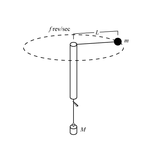

In related news, say someone is performing this standard school physics experiment :-
At some instant, they add an extra mass ##\Delta M## to the hanging mass ##M##. Will the system now asymptotically approach the new reduced radius ##L_2##, OR will it overshoot, oscillate and then settle down?
Maybe it will overshoot and oscillate due to the inertia of ##M##. So in that case let us consider a force ##F## which is produced not by a hanging weight but some other non-inertial means (like a very long spring with negligible mass). Will it oscillate after increasing the force by ##\Delta F##?
Swamp Thing said:
So in that case let us consider a force F which is produced not by a hanging weight but some other non-inertial means (like a very long spring with negligible mass).
It appears that you are contemplating orbits under a central force whose magnitude is fixed. In general, the central force problem is well studied.
By Bertrand's theorem, the oscillation for a constant central force will not yield a closed orbit -- ignoring the trivial case of a circular orbit. Only the inverse square (ordinary gravity) and directly proportional (harmonic oscillator) force laws give rise to closed orbits that are not circular.
