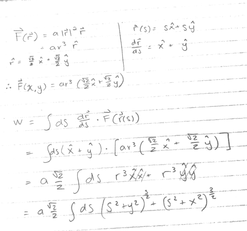

Work done by a force along the path
\vec F(\vec r)=α|\ vec r 2 \vecr.
r(s)=sˆx+sˆy,
If the first equation for force is not formatted please refer to the pic.
I did not post my full attempt as the problematic equation leads to a complex integral.
Should I be converting r vector into its univector. The two outlined equations refer to the force. I am making an error transforming the force into x_hat and y_hat format. Any advice is appreciated I am quite stuck

To calculate the work, you're trying to evaluate
$$\int_C \vec F \cdot d\vec r = \int_0^1 \vec F \cdot \frac{d\vec r}{ds}\,ds,$$ right? You have expressions for ##\vec F##, ##\vec r##, and ##d\vec r/ds##. Just substitute those into the integral and then evaluate the dot product. What do you get?
Likes etotheipi and PeroK

How do I do the dot product if F is in terms of r(vector) and dr is in the form ˆx+ˆy. How do I convert r_vector in its x_hat and y_hat components
You have an expression for ##\vec r## in terms of ##\hat x## and ##\hat y##, don't you? Substitute that into the expression for ##\vec F## where appropriate.

No that's the issue. My ##\vec r## in terms of ##\hat x## and ##\hat y## is not correct.
Is the ##\vec r## in my force equation maybe related to ##\vec r##(s) and therefore just the sine and cosine components of a straigth line graph with gradient 1 between the specified points?

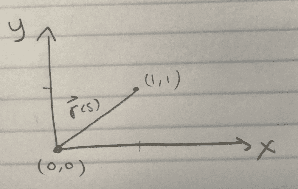

Draw a vector from the origin representing ##\vec r##. What are the coordinates of its endpoint?

0 and 1, so I am assuming it is as easy as ##\vec r##. 1cos(45)##\hat x## and 1sin(45)##\hat y##

Sorry, we integrate from 0->1 So cartesian be 1,1 endpoint.

I understand your questions as though you are referring to the origin? In which case the ##\vec r## can be seen as a straight line in the form y = x? I am just trying to understand what is specifically incorrect with the picture above as I can't see a mathematical error.

No, ##\vec r## represents a point, not a line.
Yes, you can draw a line from the origin to that point, but why should it be the line y=x? It is not necessarily at 45 degrees.

Do you have a graph to show us?
Domain for s is including and from 0 to including 1
Is that the path?
How is the force acting along it?

So, you wrote ##r=\hat x+\hat y##. I presume you meant ##\hat r=\hat x+\hat y##, but that is incorrect. What is the magnitude of ##\hat x+\hat y##?

I don't understand the final step in the above. You seem to have substituted s2+x2 for r2 in one place and s2+y2 for r2 in another. Neither is correct.
Btw, it would have been easier without switching to x and y coordinates. Just write the integral in terms of ##\vec r##.

So r2r⋅r = ?

No, integral ##.\vec {dr}##.
MyoPhilosopher said:
Out of interest what would be the correct expression of r2 in terms of s,x and y?
##\vec r=s\hat r##, so what is r2 in terms of s?
##\vec r=x\hat x+y\hat y##, so what is r2 in terms of x and y?
