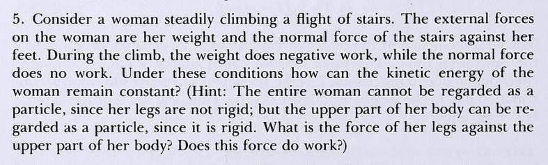

What force does positive work such that the woman's kinetic energy remains constant?
W = F * d
This question states that the normal force of the stairs on the woman does NO work. I do not understand how this can be. I would reason like this:
The woman propels herself up the stairs using her legs. Her legs push down against the stairs, and the consequent normal force pushes upwards on her legs.
Therefore it is the normal force that's directly responsible for her progress. Since she moves at a constant speed, this normal force must be equal and opposite to her weight.
The normal force does positive work.
Why am I wrong?
It's certainly true that the normal force is needed for her to make progress up the stairs, but that doesn't mean that force is doing the work. For a force to do work on an object, there must be displacement at the point of contact.
Another example: Imagine you were lying on the floor and then stood up. Does the normal force do work in that case?
Another hint: What's the source of the energy needed for her to climb the stairs (or for you to stand up)?

Suppose a force is applied to point P on an object.
The force only does work on the object when P moves in the direction of the force.
(Or, to be a bit more rigorous, work is done on the object by the force when P has a non-zero component of displacement in the direction of F. The work done is the dot product of the force and displacement: ##W = \vec F \cdot \vec s## if you have met the dot product.)
The normal force of a stair on a foot does no work because there is no relative movement between the foot and the stair while they are in contact.

Further to the other replies, suppose you were to stand on a stack of blocks with legs bent then straighten them. All the blocks exert a greater normal force as you accelerate. Which is doing the work?

How about "the normal force from the stair does no work because the contact point is not displaced in the direction in which the force acts"?

The version I offered has the merit that it says ##\vec F.d\vec s=0##, as required.
Note that whether a force does work depends on the reference frame. To a person riding an up escalator, neither the normal force from the stair nor gravity do work. To the bystander at rest relative to the Earth, gravity and escalator are doing equal and opposite nonzero work.

Neither energy nor work are "invariant". Both depend on a choice of reference frame. As this post by @sophiecentaur from earlier in the week points out.
The formulation by @haruspex takes this into account perfectly well: ##W = \vec{F} \cdot d \vec{S}##. Pick a frame where the point of application of a force is motionless and ##d \vec{S} = 0##. Pick a frame where the point of application is moving (like an escalator or a pickup bed from the Earth frame) and ##d \vec{S} \ne 0##
The intent of the problem setter for the OP hear appears to be that the rest frame of the Earth is adopted. We can see that because of the claim that "the normal force does no work". This means that we have adopted a frame where the stairs is motionless.
The OP makes another important point: "her legs are not rigid". It would appear that the textbook where this problem appears is making an effort to distinguish between the "real work" calculated based on the displacement of the point of contact and the "net work" calculated based on the displacement of a body's center of mass. This book appears to use the unqualified term "work" to refer to the former.
If we multiply the normal force by the displacement of the woman's feet, do we get a zero result?
If we multiply the normal force by the displacement of the woman's center of mass, do we get a zero result?
What is the effective point of application of the gravitational force on the woman?
What is the point of application of the normal force on the woman?

Technically, it is not the displacement of the point of contact that matters. It is the displacement of the material of the acted-on object at the point of contact that is relevant.
That makes the relevant displacement for a the force of road on tire (or tire on road) zero for this purpose.
It also means the the work done on a knife being sharpened can be zero and the work done on the grinding wheel can be non-zero despite the point of contact being stationary. [You can focus in on that interaction further and make it messy -- everything is messy when you focus in tightly]

Neither really captures it. This gets close:
There must be a displacement of the contact (i.e. both points together while making contact), and the direction of that displacement must have some component in the direction of the force.
Examples:
  • Riding a skateboard, constant velocity on level ground. The feet maintain contact with the board, but the normal force is perpendicular to the movement, so no work done.
  • Car driving up hill, no skidding. At the instantaneous point of contact, there is no movement. The static friction is not doing work. The work is done by the forces from the engine on the axle. This is similar to the walking up stairs example.
  • Lifting a cup by gripping the vertical sides. The surfaces in contact move in the direction of the force the hand applies to the cup, so it does do work.
But frames of reference can lead to different views. If I walk downhill past a parked car, in my frame of reference the static friction from the road is doing work on the car! Gravity, fortunately, is doing equal and opposite work on it.

It is often convenient to "zoom out", ignoring the details of an interaction and look at the bulk effects. We are back to the distinction between "real work" and "center of mass work"
Real work looks at the displacement of the material of the acted-on object at the point of contact under a particular force.
Center of mass work looks at the displacement of the center of mass of the acted-on object under a particular force. Or under the vector sum of all forces. With only one displacement to worry about, you are free to apply the distributive law and sum the forces before multiplying by displacement. ##\sum_i \vec{F_i} \cdot \Delta \vec{s} = \Delta \vec{s} \cdot \sum_i \vec{F_i}##
Zoom in (real work)...
If we are looking at the interface between tire and road, no work is being done. The two surfaces have zero relative motion (so no energy is being dissipated into heat) and, in addition, the surfaces have zero motion in our selected frame of reference (so no energy is being transferred as work between the mating surfaces).
Zoom out (center of mass work)...
But if we are looking at an abstract interface between motorbike and road, work is being done. There is relative motion between the bike and road. So energy can either be dissipated or injected at the interface. As it turns out in the case at hand, energy is injected. The bike's engine produces the energy and the drive train transmits it into the interface (the rotating and driven wheel). The bike as a whole is in motion. We are zoomed out. We ignore the details of the engine and drive train and see an abstract force from the road on a moving bike. Non-zero work is done on the bike. Zero work is done on the road.
If you are treating the acted-on object as a either point-like or as a rigid, non-rotating blob effectively located at the center of mass then you are adopting the zoomed out point of view.
If you are paying attention to the inner details of the acted-on object such as rotation, vibration, waves, eddies and moving parts then you are adopting the zoomed in point of view.

Leg extension applies the force and elevates the lady to the next step, while the alternate leg contracts forward to the next step. This repeats to create steady kinetic energy against the gravitational potential energy.

Yes. Here we have zoomed in to consider the leg as an abstract interface between moving body and stationary stairs. The original problem statement urged us to do so.
If we wanted to, we could zoom in further and look at the gluteus maximus, thigh and calf muscles and see that those are the actual energy sources while the tarsals, metatarsals, tibia, fibula, femur and the associated ligaments and tendons do zero work.
