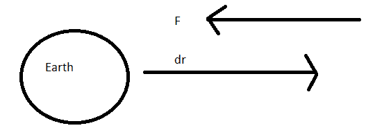

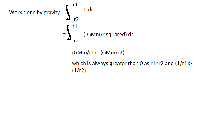

Suppose I have a spacecraft at a distance r1 from the Earth's center. Then, I move the spacecraft to a distance r2 from Earth's center. I want to calculate the work done by gravity on the spacecraft .
Here is what I do (Sorry, I don't know how to use LaTeX):
In the above case, I assume that:

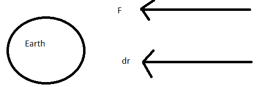

In the second case, which is following the link to the website is this: I bring the S/C from a distance r2 to r1.
And here is my calculation:
Questions:
1. In the first case, work done by gravity is negative. But I remember there should be a negative sign when calculating work done in my equation (because Force, F and displacement, dr are in opposite direction), why is it that now I don't have to put it but I can get the right answer? Why
2. In the second case, I follow the website link as shown above but the same question pops up, now Force, F and displacement, dr are of the same direction but remember that I define F is opposite in direction to dr, so supposedly there should be a negative sign as well in the formula since now, F is of same direction as dr.

Think of the force of gravity having a magnitude of F and a direction towards the earth. When moving the object away from the earth, the work done by gravity will be negative since the force and displacement are opposite; when moving towards the earth, the work done by gravity will be positive.

For the first case, where I bring a spacecraft from r1 (closer to Earth) to r2 (further away from Earth), I Integrate from r1 to r2 (integrate from initial position to final position), which makes sense, but when you consider the maths for F (gravity) and dr (displacement), the signs will confuse you easily. The usual definition is F is in the opposite direction of r. So, even when you integrate F with respect to r (dr), there must be a negative sign in the equation since F is opposite in direction to dr, but if you put that into the equation, you get the wrong answer.

"dr" points in the direction of increasing r. The force has a minus sign, since it is directed towards decreasing r. (And r is the variable of integration.)
When integrating from r1 to r2, you'll get a negative answer (as expected) since you are calculating the work done by gravity in moving the object away from the earth. The change of sign when moving towards the Earth is automatically handled by the change in order of the integration limits.

Your mistake is counting the negative sign twice in the second case. (Or at least being tempted to.) "dr" always points outward.

Ok, let me see if I understand this.
When I am doing integration for work done by gravity or against gravity, I just have to use the integration formula integrate F with respect to r (dr) regardless of whether the object (in our case here, it is the spacecraft ) is moving away or towards Earth.
Then I only have to consider the limits of integration. For objects moving away from Earth (assume r1 is closer to Earth than r2 is), I integrate from r1 to r2 (so, r2 is at the top of the integral sign and r1 is below it, like this:
) and I will get a negative work.
For objects moving closer to Earth, I integrate from r2 to r1 (so, r1 is at the top of the integral sign and r2 is below it, like this:
) and I will get a positive work.
So, all in all, I don't have to bother about the signs of F and dr while doing the integration work, I only have to be concerned with the limits of integration. Am I correct?
But what about our traditional way of viewing things, where we say Work done = F dot s cos (theta). Apparently, theta in our first case (assume gravitational force is constant) would be 180 degrees. So, there would be a negative sign when calculating work done against gravitational force.
Does this mean that the limits of integration already "replace" the function of cos (theta) in this case, i.e. determine the negative work done for the "against gravity" case (the first case, spacecraft getting away from Earth)?

I think I see it. I notice my mistake in the second case. "dr always points outward." But even if dr points outward, I still integrate from r2 to r1, am I correct, mentor Doc Al?
Exactly.
