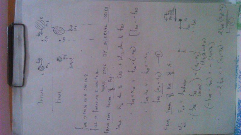

Dear Experts,
Trying to analyze the work done by internal forces in a very simple two particle system which is attracted to each other with a constant force, i performed calculations based on two frame of references, 1.The center or mass frame of reference and 2. Frame of reference of one of the particles say A.
Computing the work done by internal forces on a system of particles, under two different frame of references, i obtain two different answers.I have uploaded the image of the derivation.
The answers for the change in kinetic energy will be hence different in both frame of references. Is that normal?
What are the cases where the work done by internal forces becomes 1.zero, 2. positive, 3. negative ?
That is correct. Work is frame variant.
Yes. The important thing is that energy is conserved within each single frame. It doesn't matter that it is different from frame to frame.
Likes Nikhil Rajagopalan
Thank you Dale, i understand that the work depends on the frame of reference.
But is it true that the total energy of the system of particles must remain constant if there is no external work done on it, irrespective of the frame of reference. Is there any way i can compare the total energy of the system in different frame of references and show that they are all equal. Considering the problem i worked on in the image shared ?
