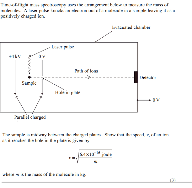

now I know this has something to do with energy done on electron and KE.
apparently work done on electron is:
W = eV
BUT surely this implies V is constant. as the charge moves, will not V change?
hence it should be
W = 0.5*eV?
found it
my book says V is the p.d that charges MOVE THROUGH not are in :)
