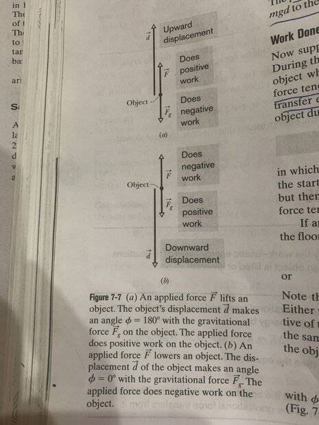

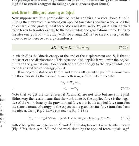

B Work done in lifting and lowering an object
The discussion focuses on the work-energy principle in lifting and lowering an object, particularly a book. It emphasizes that during uniform motion, the work done by the applied force equals the work done by gravity, resulting in no change in kinetic energy. When lifting the book, the applied force initially exceeds gravitational force, causing acceleration, while during cruising, the forces balance, maintaining constant speed. The conversation clarifies that while the kinetic energy may be zero at the start and end, it can increase during the lift due to the work done by the applied force. Ultimately, the work done by the applied force is dependent on the force applied, despite the energy being transferred to gravitational potential energy.
rudransh verma
1,067
96
##\Delta K=K_f-K_i=W_a+W_g##.(##W_a##, work done by applied force and ##W_g##, work done by gravity) In case of uniform motion with velocity u, kinetic energy is equal. Change is zero. ##W_a=-W_g## If one force transfers energy into the system then the other takes out of the system. Energy of the system remains constant. Body stays in constant motion.
But when we talk about lifting a book from rest and putting it on shelf, one force provides energy to the system and other one takes out. The change in kinetic energy is zero. Then how does the body move(accelerate) from rest to the shelf.( It’s kinetic energy is always zero)?

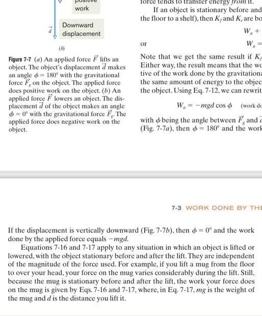

Equations 7-16 and 7-17 apply to any situation in which an object is lifted or
lowered, with the object stationary before and after the lift.
They are independent
of the magnitude of the force used. For example, if you lift a mug from the floor
to over your head, your force on the mug varies considerably during the lift.”
The first line is very confusing in bold. It is not clear whether the eqns 7-16 and 7-17 are applicable during cruising or the entire motion of the lift.
Using the example of the elevator of a previous thread:
One person is transported from the first to the second floor.
The elevator was not moving the body of the person, or providing kinetic energy to it, at the beginning or end of its stroke.
Once at the second floor, the body of the person had additional mechanical energy, which could only be measured by the gained altitude or distance traveled against the natural gravity acceleration or weight force.
An external observer can't tell how fast the elevator moved up or how the tension in the cable varied during the first to second floor stroke.
The energy that the elevator transferred to the person's body was not natural, fuel had to be combusted to generate mechanical work, then electrical work (motor of the elevator), then mechanical work again (variable tension of the cable times height of second floor respect to first floor).
Now for the bold text:
The tension of the cable must have ben variable during the stroke, since the person was accelerated first, moved at constant velocity by mid stoke and finally decelerated to a stop before the doors of the elevator opened at the second floor.
That variation of the force could have taken many forms.
It could have cycled several times during the stroke, or it could have been a brutal initial force followed by a gradual reduction, or vice-verse; or it could have been very close to the magnitude of the weight force, slowing the stroke very much.
Those equations only describe initial and final conditions, disregarding the process in between.
