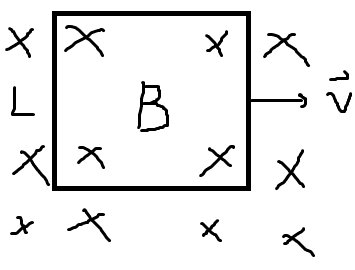

There’s a current i in the loop in the figure. The Ampere’s force iLB on a wire of length L exerts on charges in the wire but it does no work on the charges. The charges would go in circular motion if there were no wire. Then the wire exerts exactly iLB on those charges to keep the charges moving at constant speed. Then likewise the charges exert iLB on the wire. Then it is the charges that are doing work iLBv on the wire?

As the loop moves to the right on both the right and left sides there is a large ##\partial \vec B/\partial t## and therefore by Faraday’s law we get a non zero ##\vec E## field.

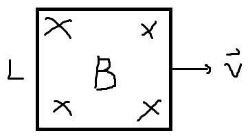

i changed that pic so that there's no change in B

You can change the pic, but now your pic doesn’t represent reality. If there is no change in the magnetic field then the wire cannot be carrying current.

I don't know, whether I read your drawing correctly: If the entire loop moves in a homogeneous magnetic field there's indeed no work done. It just moves with constant velocity.

So the work done here is due to friction of the charges in the wire. It's not the magnetic field directly doing any work. It cannot do work, because the force on each charge is always perpendicular to its velocity.

As pointed out, there's no work done. If you draw the system at two different times, nothing changes: you could take two snapshots and overlay them so the loops are in the same place and there is otherwise no difference.
