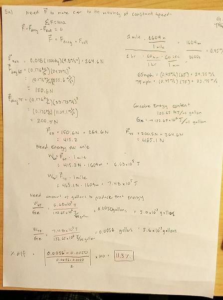

ok so this is what I have so far,
I converted 65mph to m/s and used that for the velocity to find the drag. I found both F(thrust) for each speed and multiplied it by a mile, or 1609m and divided that number by the gasoline energy content to find how much of a gallon does it take to create that energy. And then calculated the percent difference for both.
now for b & c it would be more or less the same right, except I just modify the roll forces?
You need to use different engine efficiencies at the two speeds, reading off the graph. I can't see where you've done that.
Oh I see, I made the mistake of using the one given in the problem statement. So what I do is I look at the graph, for example when driving at 65mph I see that it is about 0.199 efficiency, I multiply that by the gasoline energy content (132.65mj/g) and use that number to divide the energy found to find the gallons?
Quite so. (But it looks more like .197 to .198 to me.)
Cool thanks, now to find the time, do I use f=ma and solve for a? Where f is the sum of the forces(Fthrust - Fdrag - Droll) or would it be just the thrust force?
Then use Newtons kinematic equation to find the time such as xf - xo = vot + .5at^2? Where the change of x is one mile?
Read my lips: there is no acceleration anywhere in this question. You are to consider the car traveling either at a steady 65mph or at a steady 75mph.
