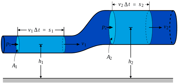

In classical and continuum mechanics if we want to find equation of motion of the body we draw force diagram and apply Newton's 2nd law.
In continuum mechanics, equation of motion actually refers to a special point of the body known as center of mass (COM) which can be proven by definition of COM and Newton's 3rd law. Consequence of this proof is that we can pretend like all forces on the body act in COM and that mass of the object is concentrated in it. This is very important proof in continuum mechanics because however complex our body might be, we don't need to care about it as long as we know where is COM and how it moves. To extend on this idea we can apply work - energy principle which states that work done by resultant force equals change in kinetic energy of the COM between two points.
Let us consider fluid flowing in a pipe like in the scheme. We will consider specific derivation of Bernoulli's equation for incompressible fluids given on wikipedia: https://en.wikipedia.org/wiki/Bernoulli's_principle#Derivations_of_the_Bernoulli_equation.
There are 2 types of derivations on wikipedia page, first uses Newton's 2nd law and the other uses conservation of energy or work - energy principle. I am referring to one which uses work - energy principle, section: Derivation by using conservation of energy.
In this derivation, system is defined as fluid volume between two cross sections ##A_1## and ##A_2##, respectively . Forces that act on it should cause its center of mass to accelerate, it is just applying Newton's second law or work - energy principle which are basically the same. In our example these forces are only pressure forces and gravity since fluid is inviscid. We will simplify things further by ignoring gravity and pretending like pipe is horizontal so that work done by gravity is zero.
Problem of this derivation is that applying work - energy principle in the way like it is done in this derivation, can only compute changes in kinetic energy of CENTER of MASS of fluid volume which is initially placed between two cross sections, NOT how kinetic energy of fluid changes between two cross sections. We want to know how does pressure difference on two cross sections cause fluid to accelerate between them. We want to watch fluid as it starts moving from one cross section to another. We can do that only if we define differential volume element on cross section 1 and do line integral of pressure gradient along streamline until we get to cross section 2.
Since in this derivation, fluid volume element on which force diagram and work - energy principle is applied is not of differential size, it is not useful since nobody cares in fluid mechanics how much does kinetic energy of COM of fluid volume element change as it flows, but how much does kinetic energy change as fluid flows from point to point.
It sounds like you are objecting specifically to the step where they say
The increase in kinetic energy is $$\Delta E_{\text{kin}}={\tfrac {1}{2}}\Delta m\,v_{2}^{2}-{\tfrac {1}{2}}\Delta m\,v_{1}^{2}$$
If so, then I agree. This does not seem to be correctly written. At least, it is a correct expression, but it does not follow directly from the work energy theorem. Since they have claimed to be using the work energy theorem they need to show how to get to this expression from that.

Well, not really specifically to that.
If we defined our system as fluid volume between two cross sections, pressure force difference should cause acceleration of COM of our system. Acceleration we calculate from Newton's 2nd law is the acceleration of COM. But, who cares about COM. We want to know how fluid changes velocity between two cross sections, not have its COM moves or what are its changes in kinetic energy.
It is perfectly valid to talk about a body of water in a control volume, the forces acting on it and its COM, as long as there is no flow over the boundaries of the control volume. I don't see why you object to that. So, who cares about the COM? I do... I don't see why you wouldn't.
However, the control volume approach cannot give you any information about local velocities. Only about the state of that control volume. So if you want more detailed information, you need to take a different approach. This however does not invalidate the COM approach...
The analysis of the pipe as you show it does draw the control volumes at two very specific locations: where there is no change in height and diameter anymore. So at that location the flow is uniform again (at least, according to the inviscid model). This means that the velocity of the COM is equal to the velocity in the entire volume at that location.

Quote from wikipedia: "the change in the kinetic energy Ekin of the system equals the net work W done on the system."
Since we defined SYSTEM as being initially between two cross sections and because there are unbalanced forces acting on it, it must accelerate due to Newton's 2nd law. System moves in direction of the resultant force, it must if unbalanced forces act on it. So, if pressure forces act on system while it moves or flows, work is done by these forces which must increase its kinetic energy of its COM. But, let me ask you a question. When did you hear anyone talking about center of mass in fluid mechanics? I never did. And that brings us to the objection. By using this derivation, you can only calculate kinetic energy change of COM, NOT how velocity of fluid changes between cross sections ##A_1## and ##A_2##. Do you understand what I am asking?
That specific quote is valid. It is just a statement of the work energy principle, which is valid and applies to this system.
Yes, which is why the quoted sentence is indeed valid.

Sure, but you can derive how the velocity of the fluid changes by calculating the change in KE of the COM. That is the point of the derivation. You don't need to start with the velocity field as long as you end with it. It is perfectly acceptable to use the COM in the middle.
Unfortunately for this derivation, the part that I quoted above is asserted without deriving the connection between the COM and the velocity field. But there is nothing wrong with using the COM to derive the velocity field.
Yes, but if we defined our system as moving fluid volume initially between cross sections ##A_1## and ##A_2## than its COM is not initially at cross section ##A_1## and the goal of Bernoulli's equation is to be able to connect changes in velocity on cross sections with pressure differences on them. Since COM is not initially at cross section ##A_1##, I can't say what velocity fluid has there and so it breakes the point of Bernoulli's equation.

Agreed. That is what needs to be fixed. Not the use of the work energy theorem, but the connection between that and the velocity field. There is nothing wrong with using the COM to derive the velocity field, but that should be explicit.

That can easily be solved: if you are interested in how the velocity changes between A1 and A2, then just make sure the COM is intersecting with these planes. Then, when reading your own arguments, you should agree with me that you do know how the velocity changes between A1 and A2 since indeed you know the velocity change of the COM.
However, that is actually not necessary. The start and end control volumes that are drawn are cylinders. If the flow is homogeneous through one plane (you do need to make that assumption) then the velocity in the entire cylinder is equal to the velocity of the COM as I stated earlier...
So, then choose a control volume that does have the COM at A1...
By the way, you insist that the given analysis needs to give the fluid velocities. Well, Bernoulli is not going to be sued if his equations do not give that. Strictly speaking the analysis only tells you something about the velocity of the control volume (or even more so, of its COM). Not of the local velocities, it doesn't say that anywhere. If that's not good enough for you, then you need to perform a different kind of analysis, but you should not blame Bernoulli for not giving you the answer you want. It also does not invalidate the Bernoulli approach.
But, once more, because the cylindrical shape of the control volumes at the start and finish of the two control volumes, the velocity of the COM has to be equal to the local velocity of the fluid.
This is not always true, if the control volume is moving through a corner, then the COM velocity is not directly related to the local velocity (I think indeed it differs).
[edit] by 'the Bernoulli approach' I mean the control volume approach. Because as stated a few times, you can derive the Bernoulli equation for a fluid parcel along a streamline, in which case you can say more about the local velocities.[/edit]

Thanks for the answer. To reply to your last comment on deleted thread, saying Cauchy equation is really nitpicking 😅.
While derivation on wikipedia should say how COM moves in time and space, it doesn't. That is the problem. It somehow connects pressure difference with change in velocity on two cross sections, while we agreed that this analysis should actually refer to how COM moves not how velocity of fluid changes between cross sections. To be clear, since in this derivation, system is defined as being a fluid volume INITIALLY between two cross sections, forces that act on it should cause its COM to accelerate according to Newton's 2nd law. This fluid volume we picked moves and accelerates in the direction of the resultant force. Here we aren't using control volume approach where control volume is fixed in space and time.
Also, if you say that to obtain how velocity changes between these two cross section, I need to pick a different fluid volume element, you are basically stating that this derivation is invalid in so much that in this derivation that different fluid volume element isn't picked. If we do choose to pick different fluid element so that COM lies on ##A_1##, than pressure will not be pressure on cross sections A1 and A2. And so we can't use this derivation to connect pressures with velocities on cross sections like Bernoulli's equation allows us.
I am not saying Bernoulli is wrong. I do agree with him. There are in my opinion better derivations than this one, but I wanted to discuss to see what is a problem with this one since it is often used. I am claiming that this derivation is either wrong or that at most can't provide what we want and because of which it isn't useful.
The velocity of the COM has to be the average velocity of the fluid in the volume. In the analysis nothing is assumed about the size of x1 and x2. So you can make them arbitrarily small, in which case the velocity of the fluid can get arbitrarily close to the velocity of the COM.
Few ideas came to me. First off, I think this derivation actually uses Eulerian viewpoint not Lagrangian like we agreed (it isn't stated what viewpoint is used which isn't very rigorous). So, we use control volume fixed in space ane time and watch how fluid flows in and out of it. Control volume is what they called system in this derivation.
Problem in this derivation is that work energy - principle is incorrectly applied because it is stated that kinetic energy of the system changes as consequence of work done by forces on it. This is wrong because Bernoulli's equation is used for stationary flow and so both kinetic and potential energy in the control volume must remain constant. So kinetic energy of system doesn't change, what changes is fluid velocity between cross sections.
This derivation isn't rigorous and is in fact wrong since it states things which are incorrect, but comes to correct solution nevertheless. It is like in logic, false premises can give you correct conclusion if your reasoning isn't logical or rigorous.
I wouldn’t say wrong. It doesn’t state incorrect things, it simply does not fully justify the correct things that it does state. It is sloppy, not wrong.
Likes russ_watters and Dario56
Statement that kinetic energy of fluid in control volume (which is called system in this derivation) changes because of work done by forces on it, is wrong if you define system as it is defined here because fluid's kinetic energy in control volume can't change in stationary flow which is a flow described by Bernoulli's equation. What changes is fluid veloxity on cross sections, not kinetic energy of the system. That is indeed sloppy and wrong.
What is strange to me how often this derivation is used, but you will not find it in any serious fluid mechanics textbook.
Likes Chestermiller
You are misunderstanding their definitions. The “system” is not a stationary control volume, it is an element of fluid. It moves and as it moves its KE does indeed change. As it says: “In the time interval Δt fluid elements initially at the inflow cross-section A1 move …”
Likes russ_watters
I agree with you. At best, it is confusing.
Likes Dario56
I thought that too, but I think this is not the case because the way derivation is carried out is like with control volume approach. Nowhere is it written that this approach is used, but if you are familiar with that type of derivation, you can see that is actually the case.
I figured this out because Chester derived Bernoulli's equation by control volume approach in one of the threads. Derivation by Chester is on this link: https://www.physicsforums.com/threa...om-work-energy-principle.1008140/post-6554344. This derivation can be found in textbook Transport Phenomena by Stewart, Bird and Lightfoot.
Chestermiller said:
The derivation that works best for me is that given in sections 7.4 and 7.8 of Transport Phenomena. This is very rigorous, and includes even viscous fluids.
Sect. 7.4 and 7.8 of which book/paper?
Transport Phenomena, by Bird, Stewart, and Lightfoot.
Likes vanhees71
  • #31
That's a more general derivation similar to the one I've given above for the special case of ideal fluids. It's a great book!
Likes Chestermiller and Dario56
  • #32
I am familiar with control volume type derivations. But, if you are going to reject what a derivation actually explicitly says and replace it with your own version and criticize your own version then if the resulting derivation is wrong you really have only yourself to blame. It is at that point no longer the Wikipedia derivation but your own personal strawman derivation. To criticize a derivation you must not reinterpret what they say, but accept what they actually do say.
Here they explicitly consider a fluid element. This element moves and changes KE. That is legitimate. Then, since the KE of any given location is constant, they can remove the portion of the fluid element which is shared by both the initial and final element and attribute the change in KE of the whole element to a difference in KE between the unshared portions.
Again, the derivation is sloppy because it does not clearly relate the COM of the work energy theorem to the KE of these unshared portions. But it is not a wrong approach.
  • #33
I didn't reinterpret what they said. Problem arises because I disagree that moving fluid element is used, but control volume actually. Nowhere it is stated that fluid volume element moves nor is it tracked in time as it moves, but masses of fluid that enter and exit control volume are in fact tracked which is exactly control volume approach. In derivation it is stated that in time ##\Delta t## masses ##\Delta m## ENTER AND EXIT the system carrying kinetic and potential energy with it. It didn't say that in time ##\Delta t ## fluid element moves as a whole and than tracks its COM .In my opinion, bad derivation which shouldn't be tought in this way.
  • #34
Dario56 said:
I didn't reinterpret what they said. Problem arises because I disagree that moving fluid element is used, but control volume actually. Nowhere it is stated that fluid volume element moves (emphasis added)
They said “The system consists of the volume of fluid, initially between the cross-sections A1 and A2. In the time interval Δt fluid elements initially at the inflow cross-section A1 move over a distance s1 = v1 Δt” (emphasis added)
I am not sure how you can be unclear. They are clearly talking about the motion of the fluid elements. The use of the work energy theorem is legitimate here.
If you wish to criticize a derivation, then do so, criticize it on its own ground. But don’t make your own strawman and criticize that strawman. I don’t like this derivation either, but your specific criticism of it is a strawman fallacy.
  • #35
Yes, but this a mistake of this derivation. They say first what you quoted, there is a fluid element between cross sections and than procced by deriving equation like there is a control volume. They mixed two approaches because they say one thing and than two the other. We agreed that if you use fluid element approach, you must compute how COM moves which clearly isn't done and derivation progresses with control volume approach even though it didn't start with that.
