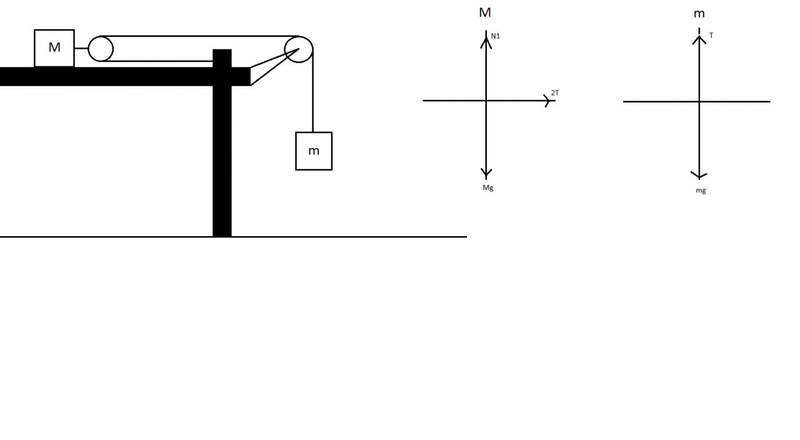

(see attatchment)
We know masses M and m, and I am trying to describe the downward speed of m in terms of the hight from the ground. There is no friction
[itex] \sum \text{F} = ma [/itex]
[itex] W_{\text{total}} = \Delta K = \int \text{F} \cdot d\text{s} [/itex]
I first need to note that the distance moved by [itex] M [/itex] is half of that moved by [itex] m[/itex] and thus the acceleration of [itex] M [/itex] is half that of [itex] m [/itex], or [itex] a_M = a_m/2 [/itex].
I first solved the problem using only Newtons laws, so from the FBD I solved for the acceleration of [itex] m [/itex]:
$$a_m = v\frac{dv}{dh} = \frac{mg}{M/4 + m} \implies v = \sqrt{\frac{2mgh}{M/4 + m}}$$
Now if I use the Work-Energy principle, I get that [itex] W_{\text{total}} = W_{\text{tension}_x} + W_{\text{tension}_y} + W_g [/itex].
This is where I think I am not understanding something:
Work done by tension on [itex]M[/itex] is equal to the work done by tension on [itex] m [/itex] even though force of tension on [itex] M [/itex] is twice that of the force of tension on [itex] m [/itex] because it travels half the distance, and since tension acting on [itex] m [/itex] is acting opposite the direction of motion, it is negative, so [itex] W_{\text{tension}_x} = -W_{\text{tension}_y} [/itex], so
$$W_{\text{total}} = W_g = mgh = \frac{1}{2}(m + M)v^2 = \Delta K $$
so
[itex] v = \sqrt{\frac{2mgh}{m+M}}[/itex]
I am not sure what I am missing that gives me [itex]m+M[/itex] instead of [itex] m + M/4 [/itex] in the denominator. I would appreciate some help!
Thanks
[EDIT] The answer in the back of the book is the same as the answer I got using Newtons laws
The masses are moving with different speeds .
Hah, wow. Total brain fart there. Thank you very much!
Even the answer you are getting by force approach is incorrect .
How is that? It's the same as in the book as well
Sorry ... its correct .
Thanks for your help.
You are welcome :)
