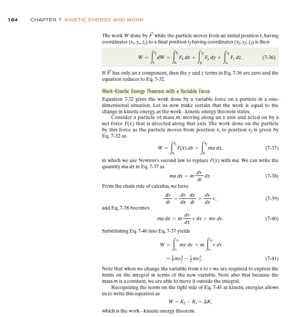

: Consider a particle of mass m, moving along an x-axis and acted on by a net force F(x) that is directed along that axis. The work done on the particle by this force as the particle moves from position ##x_i## to position ##x_f## is given by
##\int_{x_i}^{x_f} F(x) \, dx=\int_{x_i}^{x_f} ma \, dx##.
If ##F## is a variable force then how can we write ##ma##?

The formula reads (after repairing the double-subscript problems)
$$\int_{x_i}^{x_f} F(x) \, dx=\int_{x_i}^{x_f} ma \, dx .$$
As you rightfully figured out yourself that simply doesn't make sense. As I wrote already some time ago, trying to clarify your questions concerning the work-energy theorem, the correct derivation of the work-energy theorem is an integration along the trajectory of the particle, i.e., along the solution of the equation of motion, which reads
$$m a=m\ddot{x} = F(x),$$
which is an ordinary differential equation, i.e., you look for a solution ##x(t)## of the equation, involving derivatives of this unknown function.
On the other hand, just from having the equation of motion you can derive some properties of this solution, even without explicitly knowing it. For the work-energy theorem, just multiply with ##v=\dot{x}## and integrate from ##t_i## to ##t_f##,
$$ \int_{t_i}^{t_f} m \mathrm{d} t \dot{x} \ddot{x} = \int_{t_i}^{t_f} \mathrm{d t} \frac{\mathrm{d}}{\mathrm{d} t} \left (\frac{m}{2} \dot{x}^2 \right) = \frac{m}{2} \dot{x}^2(t_f)-\frac{m}{2} \dot{x}^2(t_i) =\int_{t_i}^{t_f} \mathrm{d} t \dot{x}(t) F[x(t)]=W.$$
The integral is along the trajectory, i.e., in this very general case you cannot say much more than that the change of kinetic energy ##E_{\text{kin}}=m v^2/2## is the work done by the forces on the particle, ##W##, along its trajectory.
