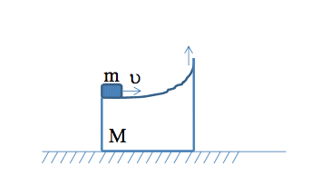

Problem: [/B]A curved plate of mass M is placed on the horizontal, frictionless plane as shown. Small puck of mass m is placed at the end of the plate and given an initial horizontal velocity v. How high the puck will shoot up from the plate? Regard radius of curvature to be much smaller than the jump height and consider that the puck leaves the plate vertically.
Conservation of Energy: KE1 + PE1 - Wf = KE2 + PE2 and Wf = deltaTME = (delta K + delta P)
Also, possibly Angular Speed: w = v/r
[/B]
From the first equation, KE1 + PE1 - Wf = KE2 + PE2
So, ((mv1^2)/2) + (mgh)) - Wf = ((mv2^2)/2) + (mgh))
Now, at the first point, h = 0. Thus, PE1 = 0. Also, since delta K = ((mv2^2)/2) - ((mv1^2)/2) and delta P = mgh - 0:
This extends to ((mv1^2)/2) - (((mv2^2)/2) - (mv1^2)/2) + mgh))) = ((mv2^2)/2) + (mgh))
Simplifying all this makes: (mv1^2)/2) - (mv2^2)/2) + (mv1^2)/2) - mgh = ((mv2^2)/2) + (mgh)) or
2(mv1^2)/2 = 2(mv2^2)/2) + 2(mgh))
Removing 2m, (v1^2)/2 = (v2^2)/2 + 2gh
I need another equation. This is when I turn to the angular speed (?), at least possibly. Momentum is not conserved since friction is present, so I am not sure what equation to make. Any suggestions on my next steps, or if I am on the right track at least? Any help is appreciated!
Note: Do I have to apply Calculus techniques here? Is that why I'm missing? I'm a little rusty on that area.

It isn't stated, but it seems to me you have to assume there's no friction anywhere, or it becomes insoluble.
You do need to consider the motion and mass of the plate.

I know this sounds strange, but can I assume there is no friction or can I just denote it as u? From the picture, it seems as if there is some rugged surface involved, but I am with you. I've been racking my brain in coming with a Force for f, but I just can't find one with velocity and mass alone.
Also, can you please elaborate why M is relevant? I can't see how it'll affect the velocity of m.
Ok, I've been tinkering with it and I am guessing since I'm assuming no friction is involved, I can finally apply the conservation of momentum, where angular momentum is the same anywhere on the circle. Am I right on this?
I'd guess that's just staircasing from drawing a freehand curve at low pixel resolution.
Samei said:
why M is relevant?
If the plate has no inertia, as soon as the puck starts to go up the slope the plate will accelerate to match the puck's speed. The puck will never reach the launch point.

Circle? The shape of the curve is not given, and is immaterial beyond some basic smoothness requirements.
I don't think angular momentum will be useful here.
Please post/repost your energy and linear momentum equations, taking into account the movement of the plate.

You are still omitting the movement of the plate.
Samei said:
mv1 + Mv1 = mv2 + Mv2
Yes, but be careful about how these velocities relate to your energy equation velocities. In the momentum equation, direction matters.
Might be safest to create separate symbols for the horizontal and vertical components of the puck's initial and final velocities.

No, it's true whenever there's no external force in the direction of the linear momentum component under consideration.

KE1 (of m) + KE1 (of M) + PE1 (of m) = KE2 (of m) + KE2 (of M) + PE2 (of m)
KE1 (of M) does not have initial velocity applied to it, so it zero. Initial height arbitrarily is zero so PE1 is also zero. KE2 (of m) will be at zero velocity at maximum height so this will also be zero.
KE1 (of m) = KE2 (of M) + PE2 (of m)
For momentum, m(v1,x) + M(v1,x) = m(v2,y) + M(v2,x)
where x is the horizontal component and y is the vertical component. Now, I'm curious is (v2,y) is zero here and would that mean my goal is to solve for (v2,x)?
I forgot to add: Is v1 for m different from v1 of M? I assumed it for the energy equations since no velocity is applied there but I am not sure if that is valid.

Right, so why the M v1x term in the momentum?

Momentum is a vector. In the vertical direction there is a normal force from the ground, which varies, so you can't use momentum conservation in that direction. Momentum is conserved in the horizontal direction since there's no friction, but v2y doesn't feature in that.
What will be the relationship between the horizontal velocities of puck and plate at the launch point?

Wrong. The top of the plate is not horizontal. As soon as the puck starts to go up a slope the normal force is not vertical. This will slow the puck and accelerate the plate.

No, but you can use geometry. How steep does the slope appear to be at the launch point?
Have another try at the equations in post #8, this time using separate symbols for the horizontal and vertical components of the puck's velocity.

No, sorry, both those equations are wrong.
They both assume the puck ends with no horizontal velocity. What makes you think that?

When at its maximum height, yes, but first we have to find the vertical component of the launch speed (i.e. the speed at the time it leaves the plate). Concentrate on that for now.
Your nomenclature for the variables is confusing. Please use these variable names, or something similar:
v = initial (horizontal) speed of puck (given)
vx=horizontal speed of puck at launch time
vy=vertical speed of puck at launch time
w=speed of plate at launch time
Samei said:
how would horizontal velocity play a part in this?
The horizontal velocity that the puck retains at launch is taking up some of the KE, so reduces the vertical launch speed.

From the information given and the picture, the slope is as steep as it can be. That means it is about 90 degrees, as it shoots upward. Also, like you said, only the horizontal momentum is conserved. So this is the relationship between the velocities of the puck and plate at launch time: mv = Mw + mvx
Rewriting the energy equation, at launch:
KE1, Puck = KE2, Puck - Horizontal + KE2, Puck - Vertical + KEPlate (Horizontal) + PEPuck
I would have three unknowns here, namely h, w, vx, and vy.
By direction of components, is it not sufficient that I include the angle (i.e., sin(90) or cos(0))?

Right, but directly upward?
Samei said:
mv = Mw + mvx
Yes, that's the horizontal momentum equation, but it's not the relationship between w and vx that you can deduce from the vertical slope at the launch point.
What will the relative horizontal velocity be?

No. I didn't realize this before, but some of the horizontal velocity will let it move further.
I am still reluctant, but is the velocity of the plate equal to that of the puck? I've also been using geometry to explain some things, but I don't think it has lead me anywhere. Say, I know that the puck will be perpendicular to the plate at launch.
Energy equation, with minor revision: KEinitial = KEpuck at launch - horizontal + KEpuck at launch - vertical + KEplate at launch, considering that PE gained is negligible.

Yes, that all looks good. Just bring in the horizontal momentum equation and you have enough to solve it.

Just an update, I have equated for it and it all seems to fall into place. This turned out to be more complicated than I initially thought it would be, but I guess it was because I simplified the situation.

You also need to consider the picture. The only way that the puck could end up moving vertically relative to the table is if the plate curled back at the edge, which it clearly does not.
