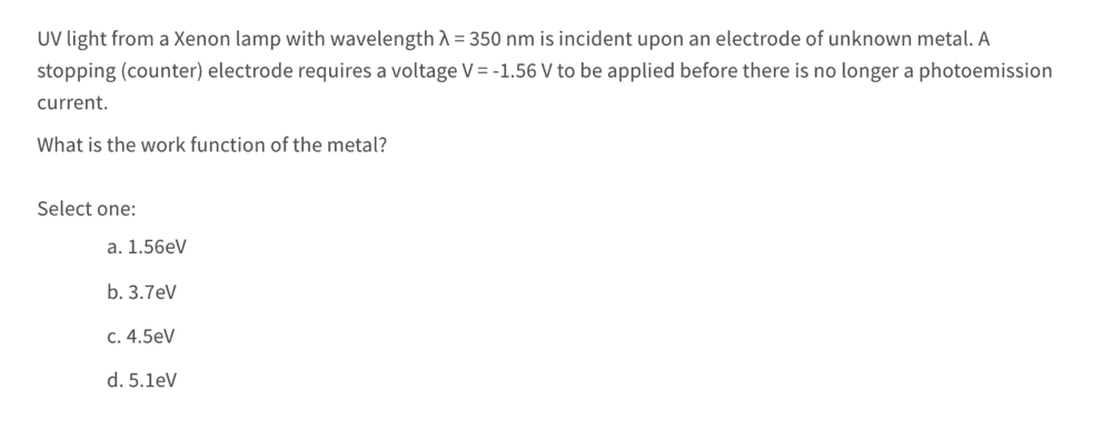

Calculate the metal's work function
See below
Question:
I have tried this and got work function to e 5.1eV
My concern is that for these type of questions, do I need to take into account the signs of some values; such as the negative sign for the charge of an electron? Or could I just take the magnitude for all the values
Any help would be appreciated! Thanks
