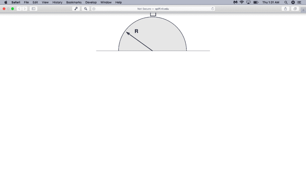

A perfect hemisphere of frictionless ice has radius R=6.5 meters. Sitting on the top of the ice, motionless, is a box of mass m=6 kg.
The box starts to slide to the right, down the sloping surface of the ice. After it has moved by an angle 20 degrees from the top, how much work has gravity done on the box?
How fast is the box moving?
g=9.8m/s^2
Homework Statement: A perfect hemisphere of frictionless ice has radius R=6.5 meters. Sitting on the top of the ice, motionless, is a box of mass m=6 kg.

From the force diagram, Fn=mgcos(theta) and m(ax)=mgsin(theta). Net force=m(ax). Thus the integral of net force=mgsin(theta)*(distance traveled). Since the circumference of half a sphere = 2(pie)(6.5m)/2 = 20.42m, the distance traveled= (20.42m)*(20degree)/(180degree)= 2.27m. The final equation should be: work=(6kg)(9.8m/s^2)sin(20deg)*(2.27m)=45.65J.
You have a little more work to do to compute that integral. theta is not constant. It's certainly possible to do it this way, but there is an easier way to compute the work done by gravity that is valid for all paths, if you only know the starting point and the ending point.

Have you ever seen the term ##mgh##?
is it work=mg(radius-radius(cos(theta)))? I got work=23.05J
mass(velocity^2)(1/2)=23.05J. Thus velocity=2.77m/s
Yes.
