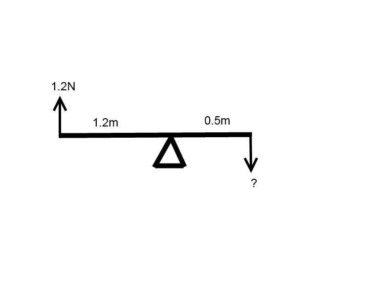

(For Q1) This diagram is effectively the same problem. Any easier to understand?
Engineer101 said:
Because why would you have a sensor that measures drag that doesn't read 1.2N?
The question doesn't ask what the sensor displays it asks for the "force transmitted into the sensor"
Ah that is a bit easier, is it 0.5N then?
Try again. Have a look at the length of the levers. Will the force be greater or less than 1.2N ?
Actually it would be more, but how do you do it without getting the answer in Newton Meter's? Is it 2.88N?
Thanks
Correct.
Torque = force * distance
= 1.2N * 1.2M
= 1.44 NM
It's the same torque on the other arm so using..
Force = Torque/Distance
= 1.44NM / 0.5M
= 2.88N
Have a go at Q2. May help to add the 2.88N force to the diagram.

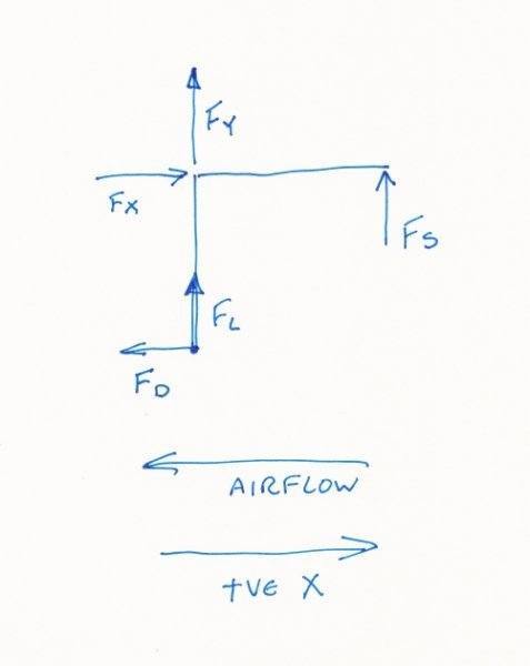

Here is my Free Body Diagram.
FD = Drag Force = -1.2N
FL = Lift Force = 1.75N
FS = Sensor force = 2.88N
FY = Y component of force at pivot
FX = X component of force at pivot
The drag force is to the left so that is also the direction of the airflow.
The problem says to assume:
X is "positive in the direction against the airflow" so +ve is to the right.
Y is "positive in the upward direction"
Have a look and then write an equation that sums all the horizontal forces to zero.
I don't know what equations they could be though?
Force of drag - x component = 0? So x component = Fd?
I would write..
FX + FD = 0
rearrange..
FX = - FD
Substitute for FD
FX = -(-1.2)
= 1.2N
Try it for the vertical.
Great thank you!
Fy+Force lift = 0
Fy=- Force lift
Fy= -1.75N
But it should be 0?
You forgot the sensor force...
FY + FL + FS = 0
FY = - FL - FS
= -1.75 - 2.88
= -4.63N
Ah of course that's vertical as well,
I thought you said the y component was 0 as it wasn't accelerating though?

So vertically..
FY + FL + FS = 0
In some problems the forces aren't horizontal or vertical but at some angle (theta) so you have to break down those forces into horizontal and vertical components then sum them. This tends to gives you equations like..
Vertical..
F*Sin(theta) + some other forces = 0
Horizontal..
F*Cos(theta) + some other forces = 0
You can have situations where an object is accelerating vertically but not horizontally. In which case the horizontal forces must sum to zero but the vertical ones won't.

Thought it might be worth checking that the torque really do sum to zero. If clockwise is +ve then...
Summing the torques about the pivot point gives..
(FD * 1.2) - (FS* 0.5) = ?
(1.2 * 1.2) - (2.88 * 0.5) = ?
1.44 - 1.44 = 0
So that's ok.
However if it's not accelerating in rotation you can actually sum the torques about any point and it will be zero. eg It doesn't have to be a real pivot.
Suppose we pick the sensor and sum the torque about that point. The equation is..
(FD*1.2) + (FL*0.5) +(FY*0.5) = ?
FX and FS don't feature because they pass through the point where the sensor is located (eg tangential distance = 0).
Substitute values..
(1.2*1.2) + (1.75*0.5) + (-4.63*0.5) = ?
1.44 + 0.875 - 2.315 = 0
This ability to pick any point about which to sum torques is handy. For example suppose there is an unknown force somewhere. If you pick the point where that force acts you eliminate it from the equation at a stroke.
