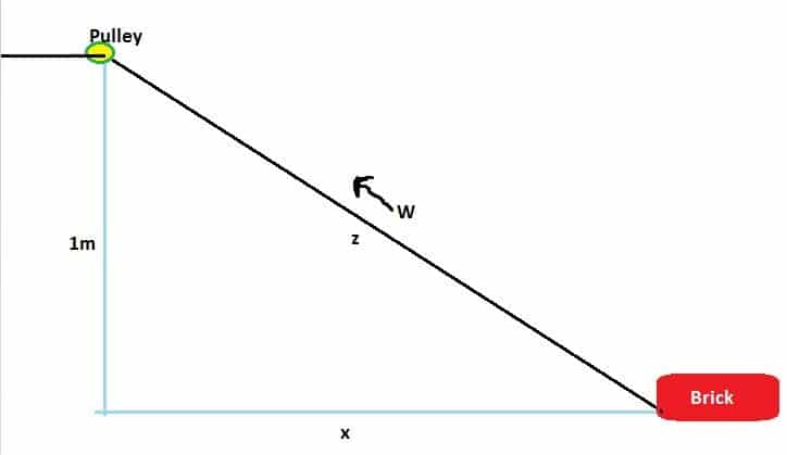

If a brick is pulled across the floor by a rope thruogh a pulley, 1 meter above the ground - and work = W, where [itex]W = 10N [/itex], (in Newton).Show that the horizontal component of W, which is pulling the brick has the size
[tex] \frac{10x}{\sqrt{1+x^2}} (*) [/tex]
Use this to calculate the amount of work needed to move the brick from x = 10 to x = 2.
This is what I have so far:
In terms of the expression (*), I'm thinking the 10x has to do with W being equal to 10N, and the W-side (call it Z) being the hypotenuse: [itex] \sqrt{1+x^2} [/itex]
Let the angle by the brick be θ:
[tex] \cos θ=\frac{x}{\sqrt{1+x^2}} [/tex]
So is the formula found by taking cosθ×10?
In terms of calculating work, I'm not sure. I first thought taking the definite integral of (*) from 2 to 10?
You're doing fine. Yes, the formula is good and since the force varies with x you need to integrate. Carry on !

Btw about the limits of integration, from the illustration I made, it looks like we are moving in the negative direction, from 10 to 2 (this is the way it was stated in the problem as well). I know under the fundamental theorem you change the sign when flipping the limits of integration.

However, when the brick is dragged up, the angle could be calculated, because we now the length of the sides ([itex]1, 8, 10.1 [/itex]) by pythagorean theorem. Should I take that into account? Since [itex] 10N \times 10.1 = 101 [/itex]. That is the z side is 10.1 long.
Edit: Nvm, I was only trying to find the horizontal work.
