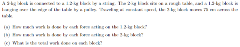

Look at picture provided
W = F * delta x
For A the 1.2 kg block is being pulled by gravity hence work is done downwards which will make work positive since it's going with the same direction as the force.
1.2 * 9.8 = 11.76 N pulled downwards
Work = F*d
11.76*0.75 = 8.82 J
The tension is the other force and since the thing is going at constant speed:
11.76-T = 0
T = 11.76
but the work for the tension will be negative due to the fact it's opposite to the motion so
-11.76*0.75 = -8.82J
For b: the forces that are acting on the box is tension and friction, since the thing is moving at constant velocity T = Fn
2kg*9.8 = 19.6
T- Fn = 0
11.76 = Fn
The work due to the tension on the 2kg is:
11.76 * 0.75 = 8.82J
Work due to friction on 2kg box is:
-11.76 * 0.75 = -8.82J
For C) I approached this two ways
since the system is moving at constant speed
Wnet = 1/2 m (vf^2 - vi^2)
Wnet = 0 due to the fact its constant speed
The second approach i did was just adding up all the work i calculated.
Can anyone clarify to me if constant speed always means 0 work.

All good.
Yes, the net work done on a body is always its gain in KE.
Constant speed always means zero net work, i.e. the sum of all the works done of the body is zero. It does not mean that no work whatsoever is done on the body.
