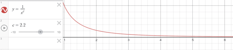

I am working on a synthesizer project and have reached a point that I am stumped on.
I am in this part trying to work from a basic curve of y=1/x^c (where x≥1):
As I understand, area under the curve between x=1 and x=100,000,000 (ie. more than I need for a rough approximation) would be:
(Symbolab Integral calculator link)
So essentially,
AUC = (100,000,000^(-c+1) - 1)/(-c+1)
Can this equation be re-arranged to roughly approximate for "c="?
I would like to be able to give an "AUC" level between an arbitrary range, and from each AUC level given, calculate approximately "c". This "c" will then be put back into the original y=1/x^c equation. The shape of the y=1/x^c curve will then dictate a part of the synth's sound.
The point is to be able to adjust the y=1/x^c curve with a knob based on "AUC" rather than directly based on "c", as "AUC" makes more sense in this case.
Is this possible to do even approximately in this way?

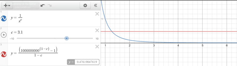

I tried to start doing that here:

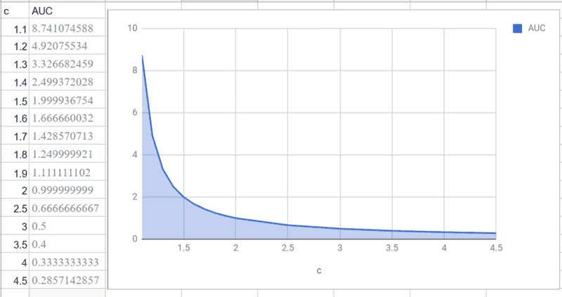

Which lead to this table and graph of AUC ~ c:
Is there any way to get a good approximate equation to describe the relationship from this or an expanded data set? How would I get that?
If not, worse case scenario, I can set up a table with 500 such values or so, and use that as a "reference" for the conversion when needed, but that's less favorable.
Thanks again!
Thanks again!
For AUC < 9 a pretty good approximation is c = 1 + 1/AUC.

You changed your upper limit of integration from ##10^8## to ##10^9##. Did you mean to?
Haha good eye. No I didn't mean to. Good eye. I don't think it will make a significant difference either way at that level though. I'll have to be more careful overall though.
That looks perfect actually! For all readings where c>=1.3 it lines up beautifully to at least two decimal places with rounding. This is more than good enough. I will try it with AUC max setting of 3.333 (c>=1.3) and see what happens.
Thanks!

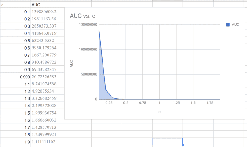

Unfortunately, I dug into my synth and I actually most typically need "c" values in the 0.7-0.8 range, which looks like a much crazier range:

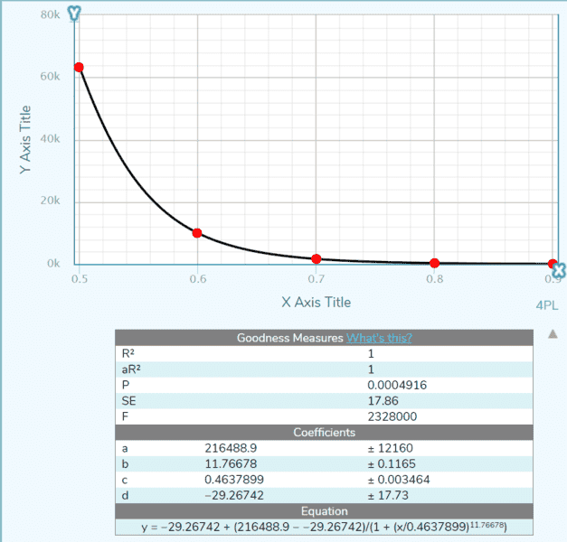

Here is their 4 PL logistic fit model with c data for c=0.5-0.9 where they are able to get a perfect fit with not too complicated an equation:

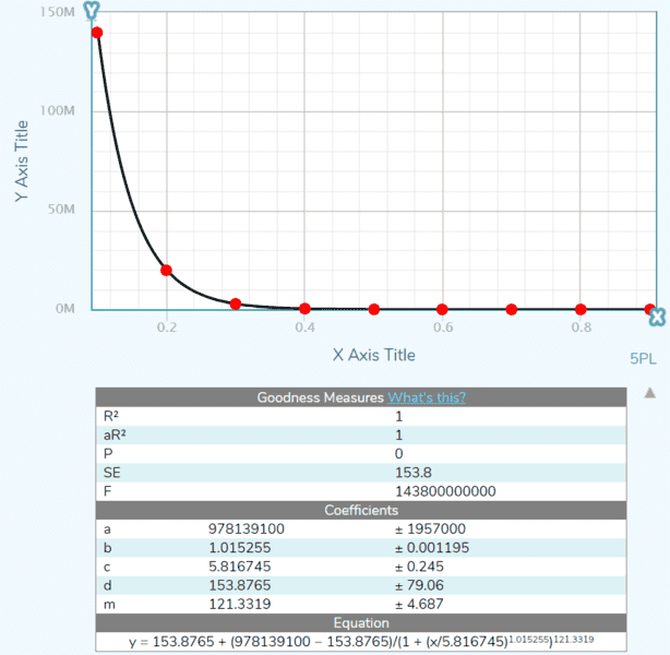

Here is their 5 PL logistic fit with the full data from 0.1 to 0.9, again matching all points well, and creating what appears to be a good curve.
If I redo these graphs with the x & y swapped, it will give me an equation that represents c = ___ * AUC ... which is exactly what I need.
So looks like the best solution is sampling some data and plugging it into this fit caclulator.
Thanks for the help! Does that make sense? Any diff between 5PL and 4PL If I want accuracy? Both look good so far.

Looks like a good approach, but that standard error (SE) is about the same size as the values you are trying to approximate. The graph is a little deceptive because of the scale (in millions). The AUC values in the 0.6 to 0.9 range all look like zero and you can't really tell if you matched them well or not. If you are not interested in values of c less than say 0.5, I suggest that you try leaving those out of your curve fit to get a better fit for the values you do care about.
