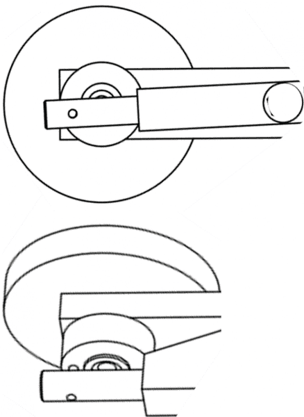

Thanks for your reply, I have produced a basic diagram (below) to show how the piston is connected to the crank-wheel (which I am treating as a flywheel). All the dimensions stated in the original post still apply.
What approach should I take to ultimately work out the angular velocity* of the axle, considering my calculations are incorrect?
*I assumed I would need to work out the angular acceleration first in order to find the angular velocity

What you are basically describing is a simple oscillating cylinder engine - similar design to a toy steam engine .
You need to start in a different place to make any headway in analyzing the performance of an engine .
Basic reason for having a flywheel on an engine is to prevent speed variations . Most engine design is done by considering the crankshaft to be turning at a constant speed .
The flywheel is then designed to even out the cyclic variations in driving torque from the cylinders (and sometimes in the reaction torque from the load) and keep the engine running smoothly .
With one cylinder and one active side of piston there are long dead zones in the rotation of the crank where the cylinder is not generating any driving force and the flywheel has to perform the additional task of keeping the engine running until the cylinder produces the next power stroke .
With the engine running at steady speed and a known load you can then work out the temperature/pressure/quantity of air or steam needed to make the engine work under those conditions and develop the practical design of the engine .
Some ways of improving your design would be :
To make cylinder double acting - ie have pressure alternately on each face of piston .
Have two double acting cylinders acting on cranks at 90 deg to each other .
Having more effective working strokes reduces the flywheel weight requirement considerably .
There's a lot more to all this . Ask any questions you like .

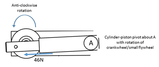

Thank you for your input, sorry for the late reply. I appreciate your design improvement suggestions, however currently I am looking to analyse the engine's performance as it is now, and then moving on to improve its design (taking your suggestions on board!). In order to see the effects of the changing the design, I need to work out the current engine's axle velocity, and I'm not sure on how to do this (as my attempts have proved fruitless). The image below pictures the engine as it is now, where the piston acts on the crank-wheel which rotates the axle, which in turn rotates the flywheel.
I wish to work out the velocity of the axle under a piston outstroke force of 46N, and I’m wondering how to go about this.
Thanks again.

You can only work out the force generated by the pressure on the piston and then work out the (varying) axle torque generated by the piston force on the crank pin . The actual running speed will depend on many things but primarily on the load that the engine is driving .
Assuming adequate supply of air/steam :
No load at all - engine will run at high speed .
Load within practical working range - engine will run at a moderate speed .
Excessive load - engine will stall .

Can the running speed be simply calculated when the engine is not driving a load? Would I need to work out the varying torque on the flywheel, or can I assume the torque is constant if I were to calculate the running speed theoretically?
The maximum no load speed will occur when all power developed by the engine is wasted in overcoming internal friction .
There is usually no easy way to calculate this speed .
Your second idea of specifying a load torque and then estimating running speed is possible and an easier calculation .
If I were to say the applied torque generated by the piston force on the crank pin is 0.6 Nm, and this torque is constant, where would I go from here to estimate the running speed?
Output power = Area of piston * Length of stroke * Mean effective pressure * number of power strokes/rev * Number of revs/second .
Output Torque = Output Power / ( Number of revs/second * 2 * Pi )
Mean effective pressure can be taken as about 0.85 * supply pressure .
Number of power strokes/rev is 1 for a single cylinder single acting engine .
The above assumes that the practical arrangement of engine and flywheel allow it to work smoothly and continuously .
The answers for Output Power and Torque are averaged values for complete revs of the engine . There will be some cyclic variation as previously mentioned .
