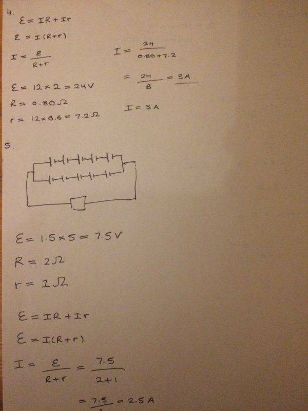

Here is what I have done

I'm not sure what I have done wrong for Q4, I assumed that all 12 cells were connected in series thus each individual emf sums up to 24V
Similarly the internal resistances must sum up to 7.2 ohms
Is there anything that I am missing for me to get a current value of 5 amps instead of 3 amps?
Any help would be really appreciated! Thanks

Your calculation is correct, given the assumptions you made about the configuration of the circuit elements. Try some other arrangements to see if you've found the best one.
I believe that the maximum current can only be drawn out when all cells are attached in series, as this is the only way to produce the biggest EMF.
Arranging some or all cells in parallel would give a smaller EMF off
So biggest current has to be 3 amps then?

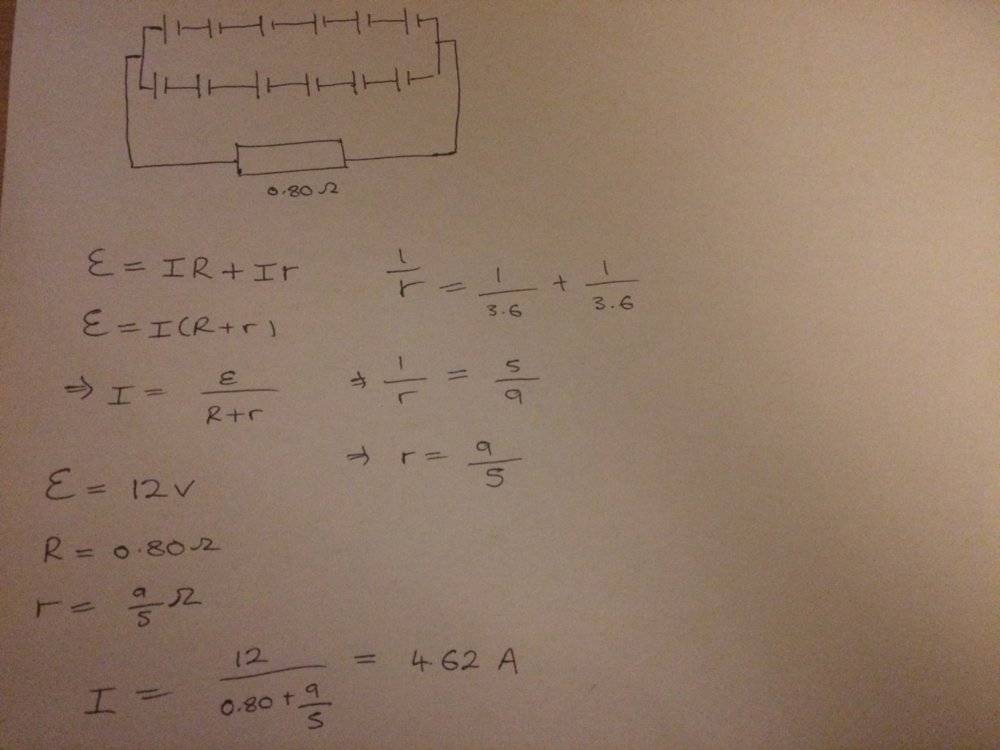

I tried one other variation now where the cells are arranged in two parallel rows of 6, and this set up is then in series with the 0.8 ohm resistor
I get a new current of 4.62 A which is close to 5 A but not exactly 5 A :frown:

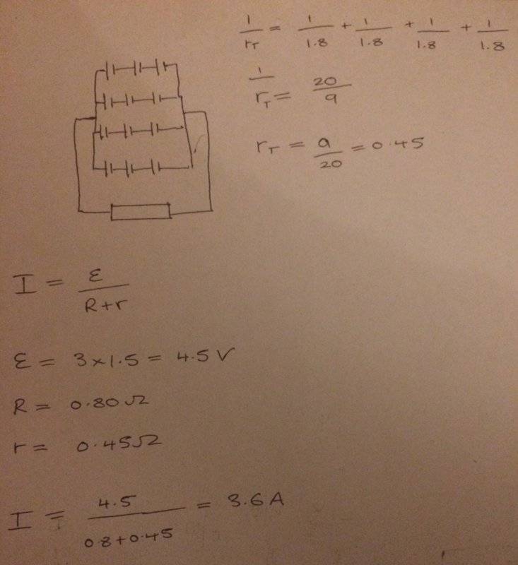

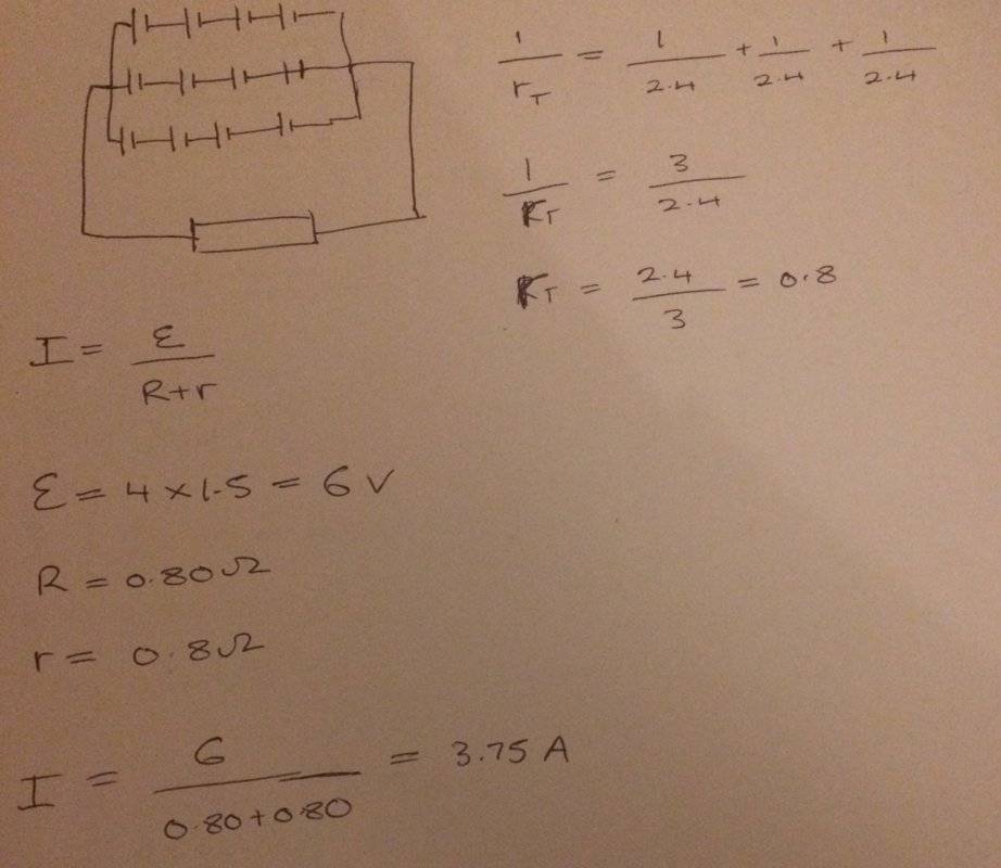

I tried with 2 more possible set ups
Where one involved 4 parallel rows of 3 cells in series with fixed resistor
and another involved 3 parallel rows of 4 cells in series with fixed resistor
But the currents that I obtain from both are either 3.6 A or 3.75 A (not close to 5 A)
These are designated as 2V cells. (!)

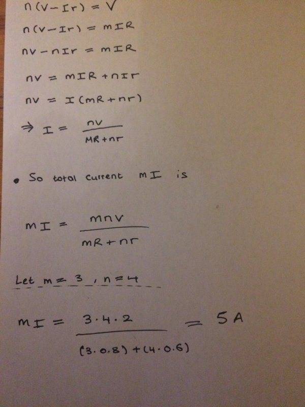

Combine that with your other equation for V to get mI (the total current) in terms of n, m, v, r and R.
haruspex said:
Right.
Combining it, I get this,
where I do get 5A once I let m = 3 and n = 4

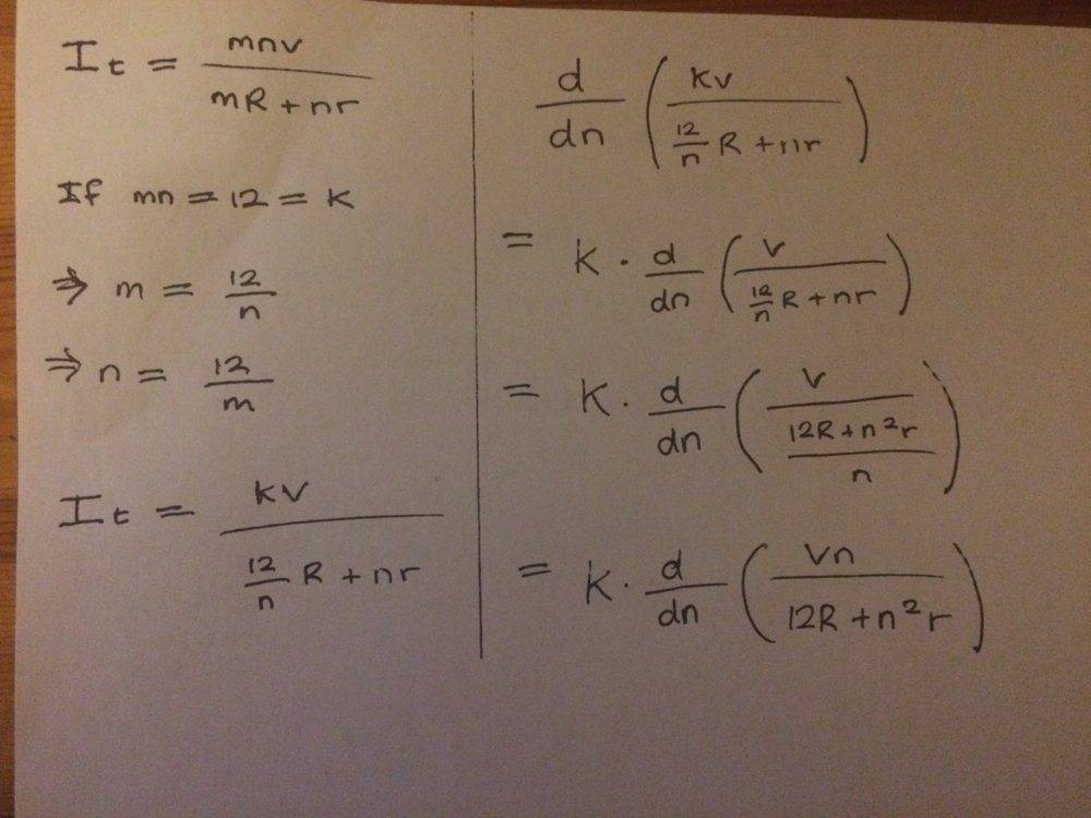

Yes, but better still you can avoid having to guess. How do you find the maximum of a function?
Likes Bolter

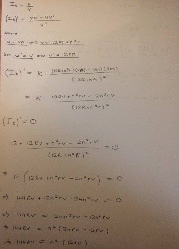

Work out the first order derivative of that function and equate it to zero. Though don't we have 2 unknowns in the function which are m and n? so you couldn't find either?
The product mn is fixed, so there is only one independent variable.

If product mn is fixed then it can treated as a constant which I'll label as k
Therefore I have total current = kv/mR + nr
What should I differentiate this with respect to?
Edit:
Would this be along the right lines? Where I differentiate with respect to n, set that derivative to zero to find n. Then subsequently get m by 12/n

Yes, that looks right. But why use K in some places and 12 in others?
  • #33
Yes sorry, should've stayed consistent and used k or 12 only throughout.
To differentiate the function I used quotient rule to do this and solve for n and m when letting the derivative be set to 0
And I do get n = 4 and m = 3
  • #34
Very good.
Note that the m:n ratio turns out always to be the ratio of the resistances, with the higher internal resistance corresponding to the wider, shorter array.
