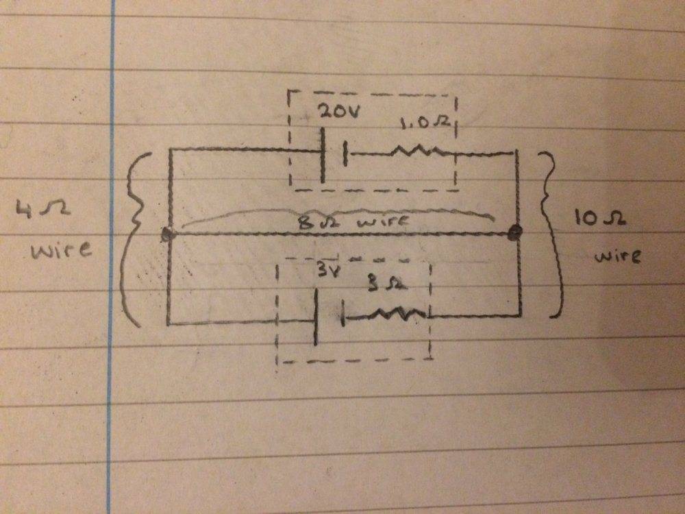

I'm struggling to see the set up arrangement for this circuit
This is what I have drawn so far
How would I fit in the third wire here and ensure I have closed loop circuit so that current can begin to flow?

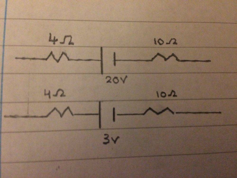

You have included the resistances of the connecting wires twice; first draw the cells with one above the other, and then add on the internal resistances. You are then connecting the poles with wires of ##4\Omega## and ##10\Omega##, but you are subsequently also connecting the midpoint of these wires with an ##8\Omega## wire.
If the resistance of the wires increases linearly with length, try splitting the resistances of each of the wires connecting the poles into equal halves. Does this help you to draw the diagram?

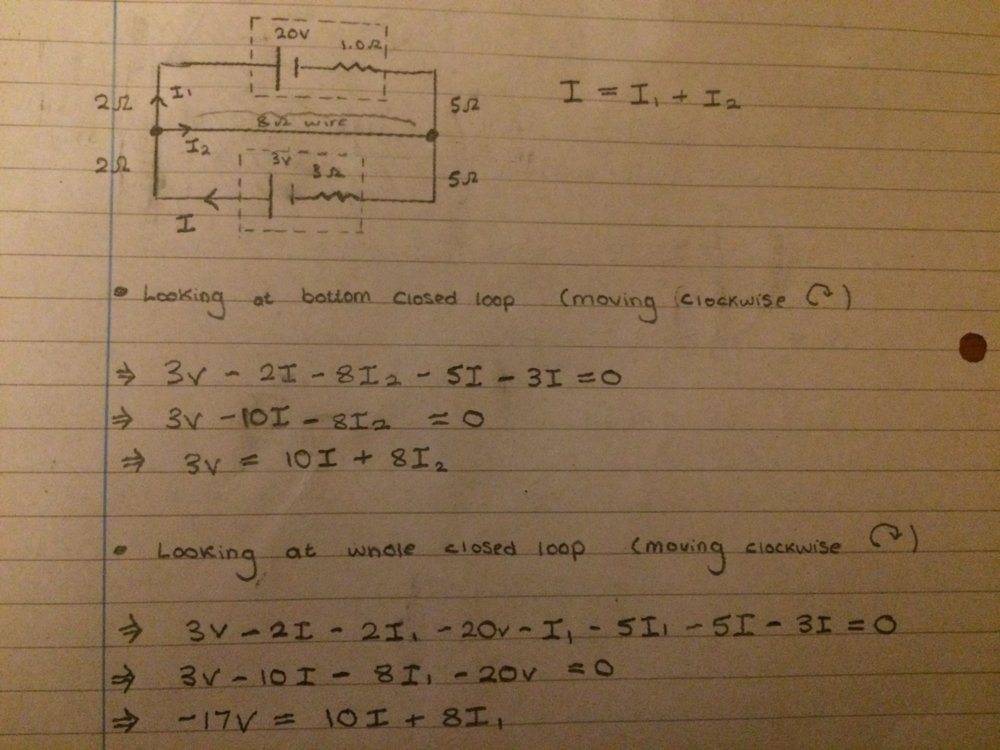

Thanks I have tried to follow through with what you have said and get my new set up looking like this?

This looks good to me, however to solve the problem you need so separate the ##4\Omega## wire into two ##2\Omega## resistors on either side of the node, and the same goes for the ##10\Omega## wire. If you want justification, it comes from the fact that each of the connecting wires can be thought of as two half wires joined together, and since both have the same length they both have the same resistance.
Then you need to solve for the currents! If you label up the currents in each branch, what equations can you write down from Kirchhoff's two laws?

Ok so I have tried to construct some equations from Kirchhoff's 2nd law, where I know that sum the voltages around a closed circuit is zero
Do these 2 equations that I have obtained from Kirchhoff's 2nd law look right?

They seem fine to me; notice that now you have 3 equations and 3 unknowns:
##I = I_{1} + I_{2}##, ##3 = 10I + 8I_{2}## and ##-17 = 10I + 8I_{1}##
This is now just a case of solving the simultaneous equations.
