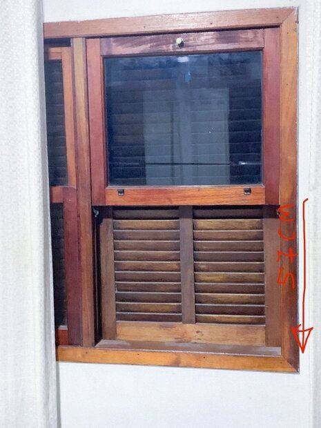

I was studying the physics involving glass and got curious while looking to my window.
Details:
The window weights 3kg.
The “ground” which the window would fall is made from wood, the same wood that holds all four sides of the glass like a frame. (common, not tempered glass)
The glass has an area of 0,27 square meters, and has a width of 3mm.
The fall would be straight down, same movement as closing the window, but instead of a supported lowering, it’d be a free fall from it’s stand.
I can imagine it breaking or not breaking, depending on exactly how it hit. How the force gets transferred to the glass will make all the difference. I wouldn't test it out though.

What happens will depend largely on how long it takes to stop at the end of the fall. The forces and deceleration are proportional to the fall time divided by the stop time. A soft weather strip at the bottom, to seal the window when it is closed, could also lengthen the stopping time and so reduce the chance of breakage.
The energy of the fall will go into making noise and vibration. The difference between the speed of sound in glass and in wood will scatter the impulse and so dissipate the impulse of energy in time and in space. The state of the putty or sealant that holds the glass in the wooden frame will also make a difference because energy will be coupled across that interface several times at different angles and in different directions.
Travelling energy would be concentrated at a gap in the sealant or at a poor joint in the timber frame. That could start a fracture through the glass. If the glass is old, or is stressed in the frame, it may fracture more easily.

We really don't know enough about the situation here. I know that you can drop a large sheet of (window) glass by just a few cm onto a concrete floor, on its corner and a great chunk will come off or there could be a crack all the way across. Otoh, we have all got away with some pretty savage treatment of similar pieces and they have been unscathed.
If the OP is about what could happen to the glass in the picture then just how slippery the track is will make all the difference.
An experiment would be out of the question so I can only suggest reasonable care and the use of window wedges if the existing felt (?) is very worn. If the OP is 'investigating' some damage by tenants or a young family member then what happened is anyone's guess. A repair wouldn't;t be too expensive.
That's why we have sash cords: if one breaks the other one stops the window falling.

Correct for corded windows but the image seems to be of a smaller, lightweight type with a friction brake. There doesn't seem to be enough room fora weight channel.
As per phinds, I can see it breaking or not breaking depending on any number of unspecified (and possibly hidden) variables.

You could test 25 times(or any number) and the results will vary each time. A pattern may surface, but not much more. There are many many factors/parameters that would apply.
Like everyone said, in practicality there are NUMEROUS factors that play into what will actually happens.
As a pure physics question, you are dropping a sound piece of ordinary glass , 0.27 sq metres, 3 mm thickness, 53 cm and want to know if it would break.
I think that is a Young's modulus question.
Young's modulus for glass seems to be ~68 GPa
The force you develop from the drop is mg --> 3kg * 9.81 m / s*s --> 29.43 N
You are applying that force on one edge of the glass
That's be the square root of 0.27 sq metres time 3 mm --> 0.52 m * 0.003 m --> 0.00156 sq metres
The pressure developed is F/A --> 29.43 N / 0.00156 sq metres --> 18880 Pa --> 18.9 KPa --> 0.189 MPa --> 0.000189 GPa
And that's WAAAAAY below 68 GPa, so if the glass hit the bottom squarely, it would survive.
Hit a little rock 1mm x 1mm wide at the bottom?
The pressure developed is F/A --> 29.43 N / (.001 *.001) --> 29430000 Pa --> 29430 KPa --> 29.43 MPa --> 0.2943 GPa and that too is still probably survivable. You might chip the spot of impact. Glass is tougher stuff than we give it credit for!
If it were a pointy little rock 0.1 mm x 0.1mm? Well then you'd be at 29.43 GPa, so then it might break if there were flaws, etc.

But it is the frame that hits, not the glass.
So you must model the low density softwood frame, with a filler seal to the glass.

There are a boatload of caveats about real-life behavior. I took the OPs post as a straight physics question. Would glass falling from a 53 cm height, landing on a 3mm wide by 52 cm long edge survive? You can calculate THAT without any further (nor not much after googling up typical glass tensile strength) information than what was provided.
And the glass is in the frame. It is subject to acceleration, and when the frame hits, it will be subject to deceleration. If it is a Young's modulus question--and I think it is--then the mass of the glass, g = 9.81, and the area that it impacts on are all that come into play. And as I noted, since the F=mg is given, the real rub is how much surface area is going to be affected at the sudden stop at the end.

Tensile strength is rated in units of pressure--not energy.
A fall from a greater height will certainly generate more energy that will have to be dissipated--but whether the energy gets dissipated or causes failure is NOT dependent upon the quantity of energy, but rather upon the force applied to an area. The glass was subjected to an acceleration. Whether it survives depends on how much surface area the force of deceleration is spread over.
Where things get tricky is in deciding what the force of deceleration is. The mass is constant, but you are going from some velocity to zero. If that happens instantaneously, the force involved is infinite. How that plays out when you are dealing with Young's modulus questions is a good question, that someone may be able to answer.
But I reiterate: Tensile strength is rated in units of pressure, and breakage requires the tensile strength to be exceeded. So, propose a numerical answer from what the OP gave, if you know or believe I have erred.

As @Baluncore, @diogenesNY, @fresh_42, @JackCatDaily, @256bits... (sorry if I have missed anyone out) and I have all said, there too many unspecified parameters to make an attempt at a numerical answer meaningful.

True but Energy is needed to do damage. Work is actually what counts so distance moved during a collision has to be taken into account. This make things much harder (more difficult).
