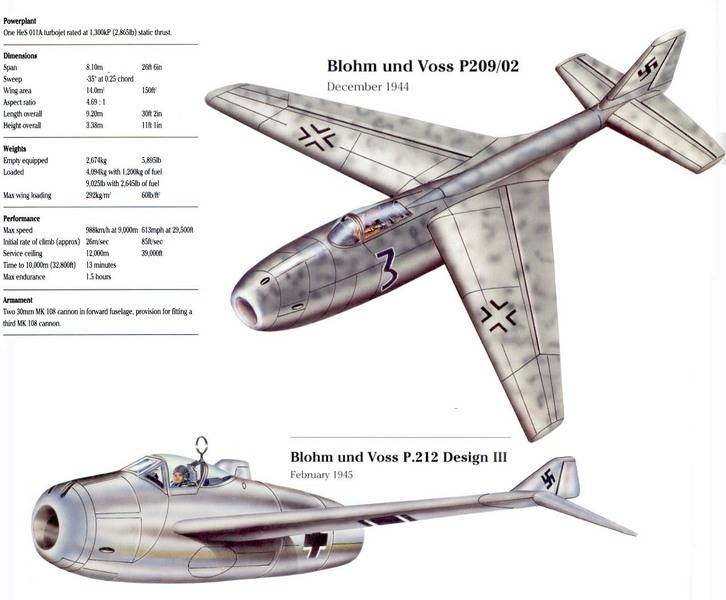

I am curious about a reverse wing sweep because it could be used on an aircraft for turning at high speeds at higher than Mach two.
There are a lot of trade-offs with a forward swept wing. One that comes to mind in modern fighters is that the yaw stability is reduced. If stealth is desired, the vertical tail is minimized and there is already a danger of yaw instability. But that is just one of many considerations.

Earlier concept.

Considering that Grumman need a computer to control the X-29 I wonder what the results of the test flight of the German prototype were.
Never flew.
A big problem with reverse wing sweep is that it is liable to cause nasty instability and flutter problems (described as "aeroelastic divergent twisting" in the Wikipedia article on the X-29) when the wing flexes. A small amount of flexing obviously tends to twist the end in a direction which will tend to amplify the effect. For the X-29 they did some clever engineering tricks to overcome that such that bending the wing one way caused the end to twist in the opposite direction.
