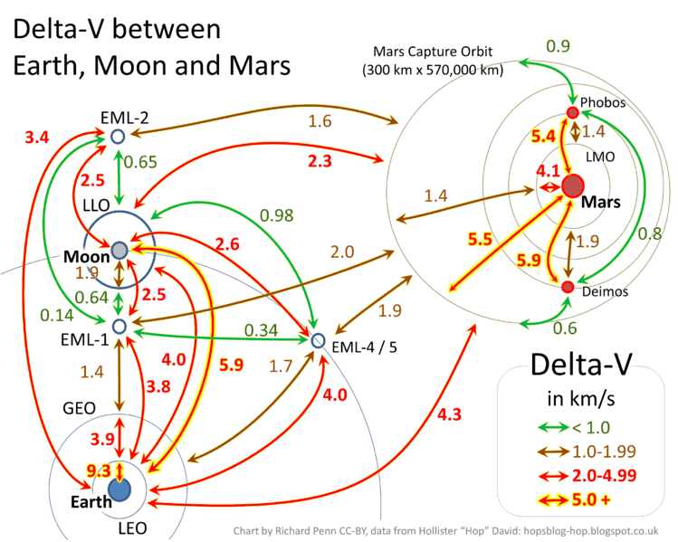

Can we try to clarify this one a bit please. The previously linked wiki article contains the following graphic:
According to that, from Earth to Mars orbit is 14.6 km/s whereas from the Moon to Mars orbit is 4.2 km/sec. Big savings. But to take off from the moon you need to get essentially the entire second and upper stages of a Saturn V to the lunar surface, plus your mining and fuel manufacturing plants, at a cost of 15.2 km/s. So it seems to me like you'd need the total mass taking off from the Moon to be at least 30% larger than what you landed on the Moon to break even. Sound right?

@Russ watters: I said Earth->Moon and Earth->Mars are similar. Not Moon->Mars. The latter is easier, but unless you start building rockets on the Moon (and that is completely out of range for now), the rockets have to come from Earth.
LEO -> Mars capture is given as 4.3 km/s in your graph, from there on you can do aerobraking and landing on Mars with a few hundred m/s additional fuel (assuming propulsive landing)
LEO -> Moon surface is 5.9 km/s. That is more than the delta_v to go to Mars.
